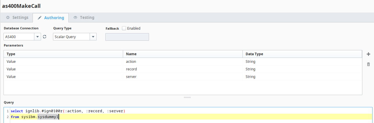

Are you using the IBM AS400 driver to make Ignition talk directly to AS400?
**Author:** ![dkhayes117](https://sea1.discourse-cdn.com/inductiveautomation/user_avatar/forum.inductiveautomation.com/dkhayes117/32/68344_2.png) [@dkhayes117](https://forum.inductiveautomation.com/u/dkhayes117)\
**Post date:** [July 18, 2025, 12:06pm UTC](https://forum.inductiveautomation.com/t/examples-of-ignition-use-cases-in-textile-industry-mes-etc/79609/6 "2025-07-18T12:06:04Z")
I'm not a 400 programmer, so I don't know much about that part of it. My colleagues have it to where I can use the database driver to prompt a program run. Which program runs is based on an action parameter and the record is where I supply arguments.
