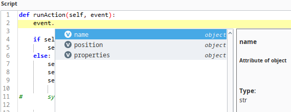

Well, yeah, it clearly has a `onMarkerClick` event. If you are asking about individual marker properties when clicking, then look at the event data passed in `runAction(self, event)`.
 ![image](https://us1.discourse-cdn.com/inductiveautomation/original/3X/2/4/247796316d92f945f40a370d035fcb7da7a24b15.png)

Great, but from where is this window opened? I mean in your snip
**Author:** ![dkhayes117](https://sea1.discourse-cdn.com/inductiveautomation/user_avatar/forum.inductiveautomation.com/dkhayes117/32/68344_2.png) [@dkhayes117](https://forum.inductiveautomation.com/u/dkhayes117)\
**Post date:** [October 21, 2025, 4:31pm UTC](https://forum.inductiveautomation.com/t/execute-event-in-map-marker-when-clicking/111616/4 "2025-10-21T16:31:42Z")
do you mean the autocomplete popup? `ctrl+space`
You can also check the user manual on these things. [Perspective - Map Scripting | Ignition User Manual](https://www.docs.inductiveautomation.com/docs/8.1/appendix/components/perspective-components/perspective-display-palette/perspective-map/perspective-map-scripting#onmarkerclick)
**Post date:** [October 21, 2025, 4:41pm UTC](https://forum.inductiveautomation.com/t/execute-event-in-map-marker-when-clicking/111616/5 "2025-10-21T16:41:14Z")
> [@Ahmed\_badawi1](#):
> ... from where is this window opened?
Right-click on the map component. Configure Events...
