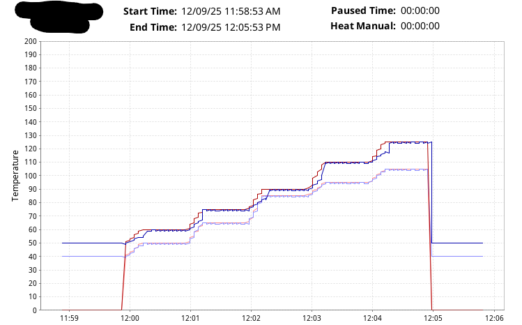

I have a report that is configured in a script. The report is generated to a PDF via the system.report.executeAndDistribute() function. This report works in Reports Preview in the Designer:
 ![Screenshot 2025-12-09 160806](https://us1.discourse-cdn.com/inductiveautomation/original/3X/a/2/a23e9b226f7342129e5cef56eec8d584940009d2.png)
But when the report is triggered in script, the final PDF has the correct data but the span of the chart doesn’t match the times as the preview does:
 ![Screenshot 2025-12-09 155644](https://us1.discourse-cdn.com/inductiveautomation/original/3X/9/5/9502c9965587ce73937ed31a9cd6058c799b3f4d.png)
I’ve checked everywhere in this forum, and elsewhere online, but I can’t seem to figure out why this happens. I expect it is the difference between the actual report and creating it using executeAndDistribute(). I hope someone here can help.
Below is the script that generates the PDF report:

Thanks for the questions. I hope this helps clarify how I am producing this report. As you can see below, all values displayed on the report are parameters. The parameters are used to display the values at the top, and the StartDate and EndDate are used for the Historical Date Range.
This is the configuration of the data for the report in Designer:
 ![Screenshot 2026-01-13 140219](https://us1.discourse-cdn.com/inductiveautomation/original/3X/3/c/3cd31dacb540b468c7b3075183224296fccd1225.png)
This is the Window running on the Client containing an EasyChart that displays the same data:
 ![Screenshot 2026-01-13 135655](https://us1.discourse-cdn.com/inductiveautomation/original/3X/b/f/bf2c6eeef066d8e9856ac285c13c92eec0a7b02e.png)
This is the report in Preview Mode in Designer:
 ![Screenshot 2026-01-13 141222](https://us1.discourse-cdn.com/inductiveautomation/original/3X/5/1/5198c9b8d0b97ee25dc3e406c77a7a62a73c9778.png)
Then this is the Report saved as a PDF using “executeAndDistribute”:
 ![Screenshot 2026-01-13 135917](https://us1.discourse-cdn.com/inductiveautomation/original/3X/f/c/fcd968bbcd78bc312974aa512a8504f2435d8865.png)
The PDF report does not use the same StartDate and/or EndDate of the parameters.

**Post date:** [January 15, 2026, 12:57am UTC](https://forum.inductiveautomation.com/t/executeanddistribute-date-range-not-matching/112715/14 "2026-01-15T00:57:49Z")
Charts displayed in Preview have a different PDI than the chart in the output PDFs. This accounts for the differences. As an example, the charts below is the exact same chart with the same data, but different DPI. Note the different increments.
 ![image](https://us1.discourse-cdn.com/inductiveautomation/original/3X/4/b/4bf87643390fdf17b7643ee59de4e3c14da6fee6.png)
 ![image](https://us1.discourse-cdn.com/inductiveautomation/original/3X/3/d/3db3ca4b2193b93fdbfab10d3b506af73f7da05e.png)
What you need to do is manually set the chart’s range rather than let it decide on its own.
Under `Chart Options > Scripting > Edit Script`
using the following code snippet as a starting point.
`chart.getXYPlot().getDomainAxis().setRange(lowerBound, upperBound);`
In 8.3 when it comes to ranges, this should not be a problem when using vectors (Use Raster is unchecked).
**Author:** ![tbennett.tdc](https://avatars.discourse-cdn.com/v4/letter/t/54ee81/32.png) [@tbennett.tdc](https://forum.inductiveautomation.com/u/tbennett.tdc)\
**Post date:** [January 15, 2026, 5:09pm UTC](https://forum.inductiveautomation.com/t/executeanddistribute-date-range-not-matching/112715/15 "2026-01-15T17:09:48Z")
This solved my issue. I am now forcing the chart range with the following:
```python
def configureChart(data, chart):
	chart.getXYPlot().getDomainAxis().setRange(data['StartDate'], data['EndDate'])
