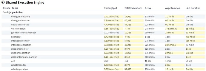

Hello everyone,
My module has several execution scripts that are making a series of REST calls. I have noticed that when some of these REST calls repeatedly fail (return a bad response), it has been overloading the Ignition system resources and sometimes leading to full crashes. I am trying to troubleshoot what may be at the root of this problem. Here is some context:
1. Here is a list of my execution scripts that are using the shared execution engine:
2. Here is a sample section of code with how I register these scripts:

1. One thing in particular that I have noticed is that there are an increasingly large number of Timed Waiting threads in the system. I cannot determine what processes are creating these threads or what they belong to by using the Ignition Gateway, but I suspect this may be related to the problem. Here is a snapshot of the system performance when experiencing some of these issues:
 ![2](https://us1.discourse-cdn.com/inductiveautomation/original/3X/c/2/c2e08bc49513b2d06ed64845d3ad4651d405fea8.jpeg)
My main suspicion at the moment is that the execution scripts are being registered with a Fixed Rate instead of a Fixed Delay. When the REST calls fail, it is causing the execution time to last longer than the rate and causes a large buildup of Timed Waiting threads. I don't have a ton of visibility into how the ExecutionManager or threading works so I was wondering does this theory make any sense? If not, any other ideas? If so, would the correct solution be to switch from

**Post date:** [August 16, 2023, 8:03pm UTC](https://forum.inductiveautomation.com/t/executionmanager-threading-issue/77956/2 "2023-08-16T20:03:32Z")
Take a thread dump from Status \> Diagnostics \> Threads. You'll see all the threads there.
ExecutionManagers used a fixed size thread pool. I'm not sure exactly what you're trying to troubleshoot.

**Post date:** [August 16, 2023, 8:48pm UTC](https://forum.inductiveautomation.com/t/executionmanager-threading-issue/77956/4 "2023-08-16T20:48:31Z")
Registering tasks with an ExecutionManager should not cause threads to be created or pile up.
You may need to use the `jstack` utility included with the JDK to get the thread dump instead.

**Post date:** [August 17, 2023, 3:37pm UTC](https://forum.inductiveautomation.com/t/executionmanager-threading-issue/77956/6 "2023-08-17T15:37:00Z")
Timed waiting threads are just threads that aren't doing anything. ExecutionManager's have fixed size thread pools, so unless you're creating new managers they aren't the reason your thread count is growing.
`register` uses fixed delay, `registerAtFixedRate` uses fixed rate. These are not likely relevant to whatever you're troubleshooting.
