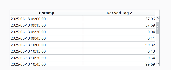

I am trying to implement a Custom History Provider. I cannot get the correct values (1 for each) to return in MinMax when displaying the data to a chart or a table.
Expected: (using SQL Lite historian)
 ![image](https://us1.discourse-cdn.com/inductiveautomation/original/3X/5/4/5467980c493533580a90f64f75d5f6edd2a37759.png)
Actual: (My History Provider)
 ![image](https://us1.discourse-cdn.com/inductiveautomation/original/3X/7/3/735b19cd874da9d6c702dcd4ef6cd26a5c81ceba.png)

Your time span is 7 hours different?
**Author:** ![andrew.jank](https://avatars.discourse-cdn.com/v4/letter/a/e9a140/32.png) [@andrew.jank](https://forum.inductiveautomation.com/u/andrew.jank)\
**Post date:** [July 8, 2025, 5:18pm UTC](https://forum.inductiveautomation.com/t/expected-return-format-for-minmax-aggregate-using-a-custom-history-provider/108239/3 "2025-07-08T17:18:53Z")
This is just an example to demonstrate what I am looking for. I'd expect to see 2 values (1 for min, 1 for max) for each timestamp. The actual timestamp and the value are irrelevant in this case.
**Post date:** [July 8, 2025, 6:51pm UTC](https://forum.inductiveautomation.com/t/expected-return-format-for-minmax-aggregate-using-a-custom-history-provider/108239/4 "2025-07-08T18:51:14Z")
It does matter. Min/Max only returns a single row if it didnt change in the time span. Probably not your issue, but apples to apples data comparison might help identify a problem.
**Post date:** [July 8, 2025, 6:59pm UTC](https://forum.inductiveautomation.com/t/expected-return-format-for-minmax-aggregate-using-a-custom-history-provider/108239/5 "2025-07-08T18:59:39Z")
I understand that for the SQL Lite historian. This does not apply to my historian which will return a value for the interval regardless of if there is data or not. I'm pretty sure that the issue is with how I am adding the data to the column in HistoryQueryExecutor.

See implementation here:
> [@How to store MinMax aggregate values as QualifiedValues in ProcessedHistoryColumn?](https://forum.inductiveautomation.com/t/how-to-store-minmax-aggregate-values-as-qualifiedvalues-in-processedhistorycolumn/109099/2):
> I figured it out. I had to create my own History Node using decompiled versions of DefaultHistoryColumn and ProcessedHistoryColumn. ProcessedHistoryColumn does not work for MinMax and cannot be used. I created the following column to be used for MinMax and the standard case of 1 value per column. import com.inductiveautomation.ignition.common.TypeUtilities; import com.inductiveautomation.ignition.common.model.values.BasicQualifiedValue; import com.inductiveautomation.ignition.common.model.val…
