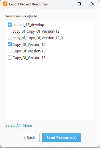

Hello, I have two Ignition Perspective projects: one for development and another used by production users.
If I "send to project" a project resource from the development project to the production project, will users see the changes as soon as they reload the affected view?

~~I don't think so. The production project would need a designer save/push.~~
I had to test this and to my surprise - yes, it does update the running clients immediately.

Thanks a lot @code_skin that´s great functionality to update production project on real time.
