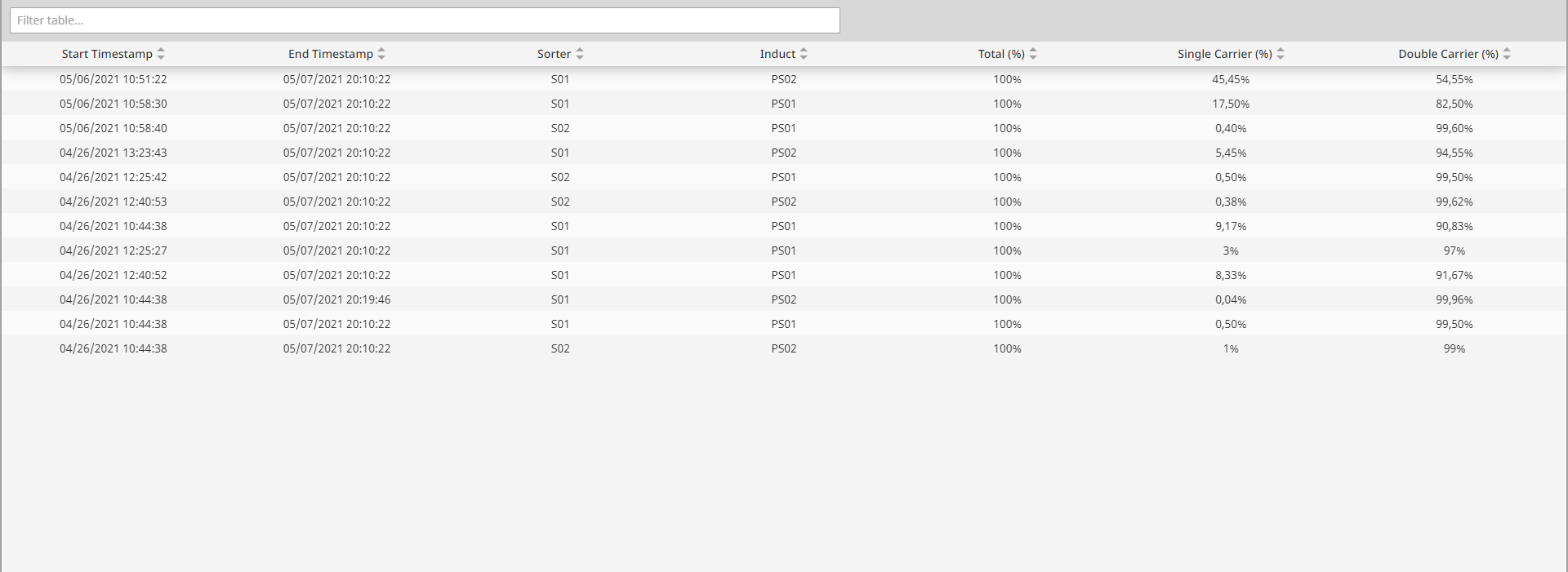

Hello people) I have questions about export table to CSV file! I want export to CSV file table which i filtered or not filtered with headers and column which visible. How I can do it, please can someone help me? And how I can export date in right format the same as like in pictures?
Original table have 17 column but I display only 7 column, I export only displayed column)
 ![image](https://us1.discourse-cdn.com/inductiveautomation/original/3X/7/9/790e95f0abe8ceeb0c3b2ff0adfab839ac8c1bf4.png)
 ![image](https://us1.discourse-cdn.com/inductiveautomation/original/3X/5/6/560ce761fbf950f5e0695cd030c8006b4e27a419.png)
 ![image](https://us1.discourse-cdn.com/inductiveautomation/original/3X/8/4/842f336eed7d11c3a68e15820f3632564429352a.png)

I had just the same question.
In my case I have a table with start and finish filters, and later a button for exporting displayed data from table to csv, but this script doesn't create any file and an error appears.
Any help, please.
Thanks
 ![FromTableToScript_Script](https://us1.discourse-cdn.com/inductiveautomation/original/3X/5/f/5f2215e010a5aa2c02ed9e59b59ee18ce0427953.jpeg)
 ![FromTableToScript_Error](https://us1.discourse-cdn.com/inductiveautomation/original/3X/2/4/24f70a495aa5464cf988836f2a4bb560a6f8f16e.jpeg)
**Post date:** [November 20, 2023, 2:13pm UTC](https://forum.inductiveautomation.com/t/export-table-to-csv-display-data/46660/3 "2023-11-20T14:13:32Z")
Looks like you have copied and pasted a script that is made for Vision. Definitely won't work like that in Perspective.
There are numerous topics here that discuss this task for Perspective:

You're right!
I'm starting with scripting and I forgot there are scripting system functions for vision and perspective (both), but there are others scripting functions especifically for Vision (eg. event.source.parent.getcomponent) or specifically for Perspective (self.getSiblings).
In any way, I got it and I paste here how to do it in Perspective
 ![PerspectiveTableToCSV](https://us1.discourse-cdn.com/inductiveautomation/original/3X/4/d/4d452610f2411d515af912de7df796157a9fc2dc.jpeg)

Hello, does the data output from the filtered table work for you? I have tried the same thing but I always get all the data from the table.
