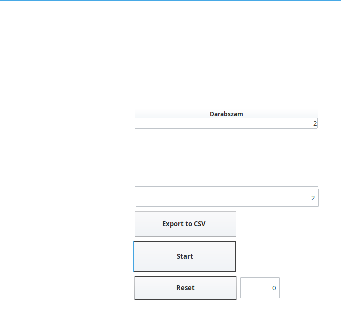

Hi everyone,
I have simple table in the vision.
 ![table](https://us1.discourse-cdn.com/inductiveautomation/original/3X/c/9/c9914736baba394768d127a79b15dddf5bebb817.png)
And I would like that this table save every hour in CSV.
I can do this in button, but I want this automatically in every hour.
Can you help me about this?
If you need more information about this, just ask me.
Thank you
Bence

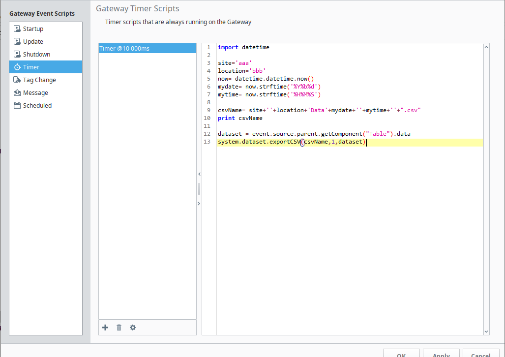

Thank you the answer!!
But doesn't work for me. I don't know why.
Here my code:
 ![code](https://us1.discourse-cdn.com/inductiveautomation/original/3X/e/9/e95573b4385db256b8d5d10256cfd497f551720c.png)
And here is the problem:
 ![event](https://us1.discourse-cdn.com/inductiveautomation/original/3X/9/f/9f9b57f6a6013ffb9f435faf17bd80cb90d2701a.png)
Do you have idea what is the problem?
Thank you!

You _are_ pointing to the table... the gateway where you are running the script has no idea of that data.

What fills you table?
A db call? a tag read?
do **that** in the timerscript, instead of refering to the table

Okay,it was my fault. You write it before.
It this table have just tag read.

Then use this:
[https://docs.inductiveautomation.com/display/DOC81/system.tag.readBlocking](https://docs.inductiveautomation.com/display/DOC81/system.tag.readBlocking)
And write the results to the CSV
**Post date:** [February 12, 2024, 4:30pm UTC](https://forum.inductiveautomation.com/t/export-to-csv-every-hour/85545/9 "2024-02-12T16:30:40Z")
As an aside, if you want this to run "every hour, **on the hour**", you should be using the "Scheduled" script type, not the "Timer" type. Timer scripts will run "every hour, from whenever the script manager started up after the gateway last restarted". Scheduled scripts allow you to define execution times much more explicitly.
