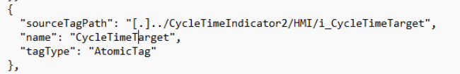

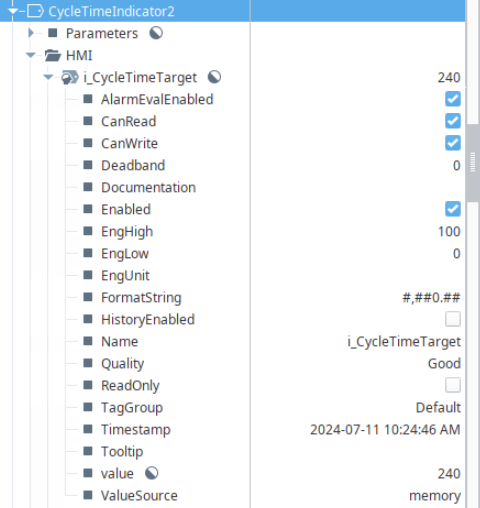

The new tag is switching back to 183. The new UDT is given a different name so I am pretty confident no external parties are interacting with it. The tag is a memory tag. There are scripts in the UDT but they do not write to it (as far as I can tell).
 ![image](https://us1.discourse-cdn.com/inductiveautomation/original/3X/6/3/63240a62881fa8b2da4973084c91bc7fd5f6108a.png)
What I did find is there is a reference tag inside a second UDT in the folder that references the memory tag in question.
 ![image](https://us1.discourse-cdn.com/inductiveautomation/original/3X/b/f/bf185b104e7ef3fcd8b97c7ba1af32a00abcfcfb.png)
If I disable the override on the value source I see the following:
 ![image](https://us1.discourse-cdn.com/inductiveautomation/original/3X/e/3/e326b336465f8ab638b5baae96bb659b2a4d7d41.png)
So I am wondering if Ignition is getting confused on all these overrides.

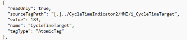

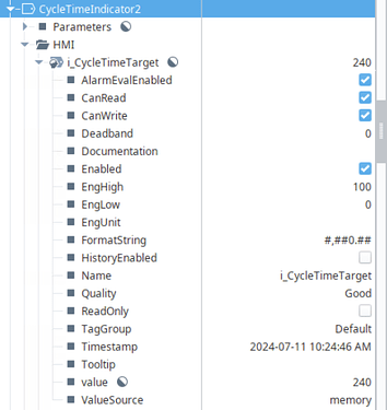

After some further investigation it seems that reference tags are bi-directional and once I got rid of the underlying override the export stopped producing a value property.
Problematic tag (I made it readOnly after the problem started)
![image](https://us1.discourse-cdn.com/inductiveautomation/original/3X/8/f/8fba0a8cb90e502f62eb79520e90e61d5afc7f7e.png)
Less problematic tag?
![image](https://us1.discourse-cdn.com/inductiveautomation/original/3X/a/e/aee1cb931dfc762a1c733a830dda5333e8f097c6.png)

So far the 183 has not returned. I think this is a case of Ignition doing something funky with my unexpected double override I had going on plus bidirectional references (which I didn't even know was a thing).
