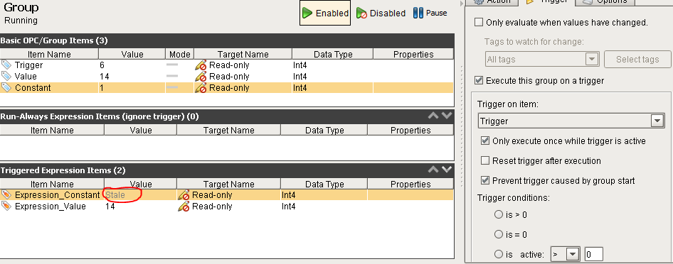

This is a follow up to [this](http://www.inductiveautomation.com/forum/viewtopic.php?f=72&t=8833) thread. I started a new topic because this seems to be unrelated to the other issue and might affect other users as well.
It took me a while to make this reproduceable, it seems to be related to order of expression items in the group. After some testing, i found the following conditions necessary to trigger the issue:
[ol]
[li]The group has to use the ‘Read’ mode instead ob subscribe. The example backup does not use any OPC items, but it still shows the issue.[/li]
[li]The expression item has to reference an Basic OPC/SQLTag Item.[/li]
[li]The expression items has to be in an certain order.[/li][/ol]

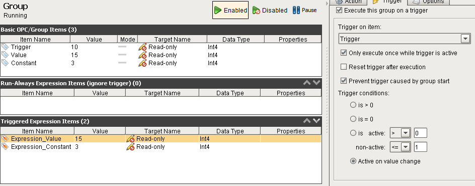

Under these circumstances, the expression item is always one trigger cycle behind. After the first trigger, it is ‘Stale’ (or shows an ‘TypeConversionError’ if the expression is more complex). See screenshot 1.
After any subsequent trigger, the Expression item shows the value from the previous trigger evaluation. (See screenshot 2).
 ![](https://us1.discourse-cdn.com/inductiveautomation/original/2X/1/1b9ebb27bf2933e7c92c1c0a338bd9513433a0aa.PNG)

Hi,
We’ve tracked this down and fixed it. It was being brought out through Read mode, but has to do with the order of item execution, and how references execute. It would also be demonstrated by having a item that references another item further below it in the item list.
The fix will be in 7.5.4. Thanks for the detailed mockup!
