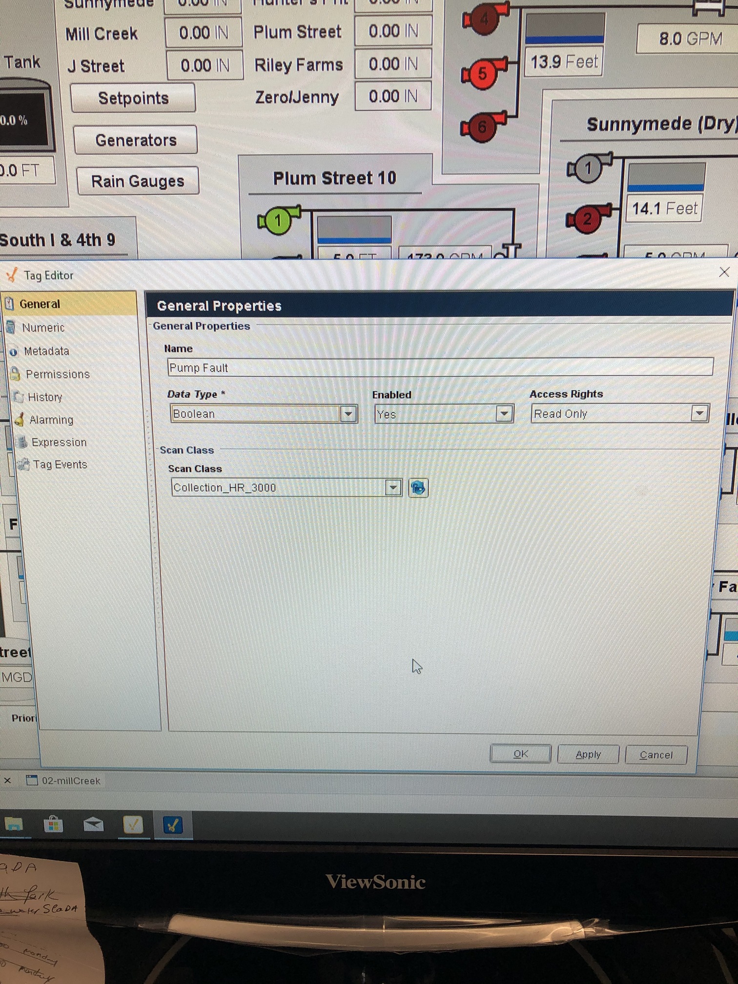

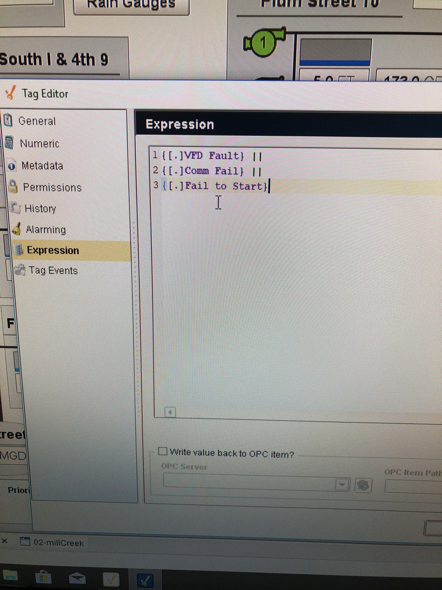

![IMG_12341](https://us1.discourse-cdn.com/inductiveautomation/original/3X/0/1/01ccc49d86b89493c82bc1d5dcc1a3150887180d.jpeg) ![IMG_12351](https://us1.discourse-cdn.com/inductiveautomation/original/3X/2/f/2f48f4c761db9e456465b154ff25e4a40c9d6c61.jpeg) ![IMG_12361](https://us1.discourse-cdn.com/inductiveautomation/original/3X/5/2/52448b668728dd9751cf68b184279a640c626455.jpeg)
**Author:** ![Isaac.Davis](https://avatars.discourse-cdn.com/v4/letter/i/ce73a5/32.png) [@Isaac.Davis](https://forum.inductiveautomation.com/u/Isaac.Davis)\
**Post date:** [December 8, 2020, 4:25pm UTC](https://forum.inductiveautomation.com/t/expression-tags-help/41294/6 "2020-12-08T16:25:58Z")
Hope these pictures actually went through, this is what im working with. Is there something i’m doing wrong here? We just switched to ignition last year and we are trying to work out all the bugs with it, we don’t have much experience with it yet. Thanks

What type of tag are VFD Fault, Comm Fail, and Fail to Start?
Edit: They look like maybe UDTs, but I’m not that familiar with 7.9.

They don’t show values in the tag browser, which is why I asked if they were UDTs.

Yes they are UDT’s
**Author:** ![zacht](https://avatars.discourse-cdn.com/v4/letter/z/ea5d25/32.png) [@zacht](https://forum.inductiveautomation.com/u/zacht)\
**Post date:** [December 8, 2020, 4:44pm UTC](https://forum.inductiveautomation.com/t/expression-tags-help/41294/15 "2020-12-08T16:44:51Z")
In your expression you need to provide a path to a thing that has a value (probably one level deeper). Your UDTs don’t inherently have a value associated. I can’t take a screen shot on 7.9, but there is a button in the top right when you’re writing your expression that looks like a tag. That will let you pick tags from a gui instead of typing them out.

@zacht is just saying you need to expand the UDT, there should be a tag inside of it that is probably an int or bool that gives the status for that alarm condition. You need to use that, the UDT itself has no value associated with it, it is unaware of the tags inside of it. If you hit the plus next to the 3 tags you want to monitor what does it give you inside of the UDTs?

Okay, may be getting somewhere now. I can now see a 1 for the value of that expression tag because for this particular pump i do have an alarm active. But when I assign the expression to the pump the pump doesnt like it for some reason.
