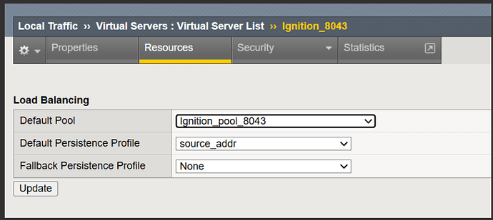

This morning we tried to stand up two Perspective servers behind an F5 load balancer. One server is already configured and running in preparation for this. When we brought up the second server, we started getting errors in existing clients. As they would navigate they would get the initial perspective loading page, but it would stop at "Connecting....."
Log file shows these errors on both servers during the time both servers were active in the load balancer:

After trying different things it seemed like we never could get good stable connections.
We did confirm that both servers are setup identical and had all the projects copied via EAM. We are able to use both servers independently without issue.
Wondering if anyone has any words of wisdom or gotcha's we should be looking for at this point?

A couple support tickets where this error was encountered were solved by clearing browser cache/cookies... unclear if a load balancer was involved in these.
The only piece of advice I have for load balancer setup is that sessions must be sticky. Others have more experience I'm sure.

Default Persistence Profile is what was needed:
This is the screenshot they gave me, hopefully this helps.
 ![image](https://us1.discourse-cdn.com/inductiveautomation/original/3X/f/3/f3b138b7f760b9ed1d65bcb5901e2ea3669cb415.png)

Thanks you so much , the default persistence profile : source\_addr works well for us !
