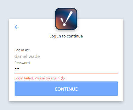

**Author:** ![Daniel\_Wade](https://avatars.discourse-cdn.com/v4/letter/d/3e96dc/32.png) [@Daniel\_Wade](https://forum.inductiveautomation.com/u/Daniel_Wade)\
**Post date:** [December 9, 2025, 7:32pm UTC](https://forum.inductiveautomation.com/t/failed-login-attempts-to-audit-log/112709/7 "2025-12-09T19:32:45Z")
Where does the text in red saying the login failed come from?
On the surface, I do not have a non-custom way of getting the AD logs and putting them into the DB.
 ![failed login](https://us1.discourse-cdn.com/inductiveautomation/original/3X/4/6/4640a4772b3f70741e0ae9f85e7b9c96b17daac3.png)
**Post date:** [December 9, 2025, 7:37pm UTC](https://forum.inductiveautomation.com/t/failed-login-attempts-to-audit-log/112709/8 "2025-12-09T19:37:39Z")
Hang on, this looks like the Ignition internal IdP, not an external one. Doesn't help because I don't think our internal IdP currently has auditing support. Gonna ask somebody who knows more.
**Post date:** [December 9, 2025, 7:44pm UTC](https://forum.inductiveautomation.com/t/failed-login-attempts-to-audit-log/112709/9 "2025-12-09T19:44:24Z")
K, sounds like it was a terminology mismatch.
This is the Ignition internal IdP, configured against an AD hybrid user source, by the sound of it.
The ticket to reference is IGN-5725, which is to add auditing support to Ignition's internal IdP...
I don't have better news or a suggested workaround, but maybe somebody else does.

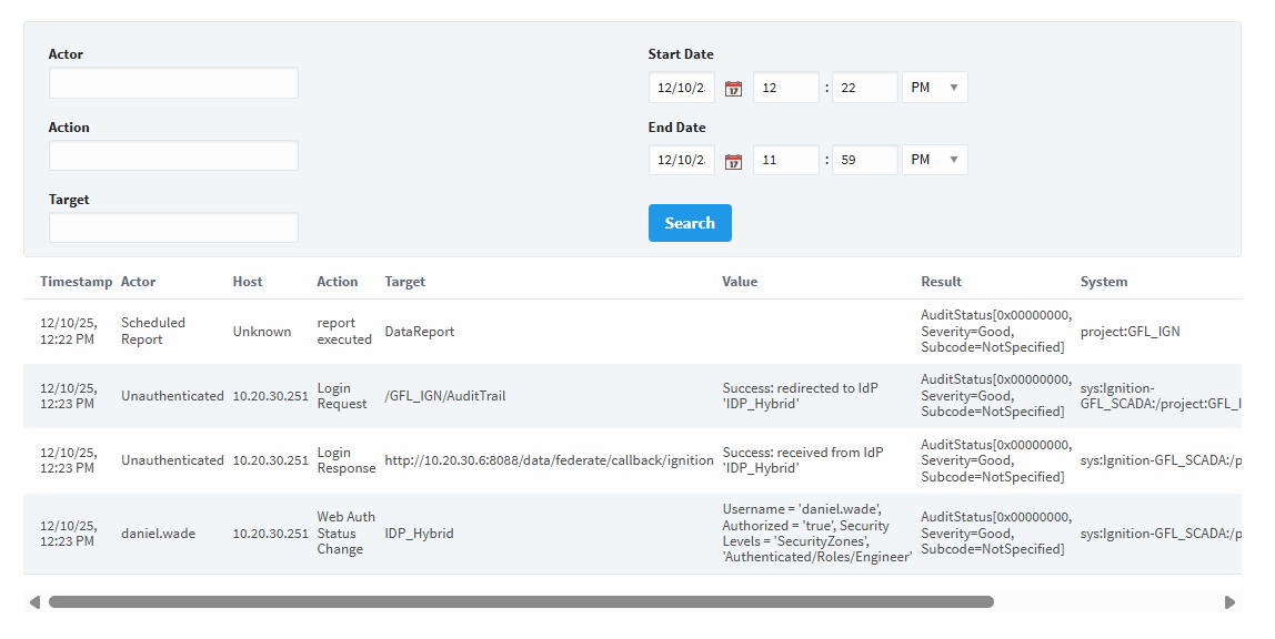

**Post date:** [December 10, 2025, 7:29pm UTC](https://forum.inductiveautomation.com/t/failed-login-attempts-to-audit-log/112709/10 "2025-12-10T19:29:31Z")
Here is some more information. Here is a locked user response stored in the logs, but it did not get captured by the audit log. I know the manual says this was added 8.1.14, so I’m not sure why its not getting caught by the audit manager.
 ![AuditLog_NoLockedUser](https://us1.discourse-cdn.com/inductiveautomation/original/3X/4/1/41417fac8bd35afb2e802c20d9aeb6e594ff3635.png)
 ![IgnitionLog_LockedUser](https://us1.discourse-cdn.com/inductiveautomation/original/3X/1/1/110e07b8ae3574c4b79ec2cb119ec7133220595e.png)
