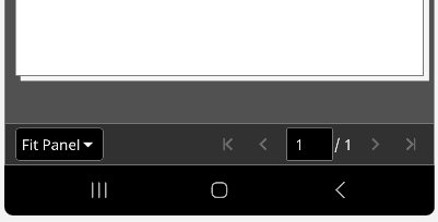

I’m noticing that the two “allow” options on the ReportViewer component in Perspective don’t show up on the Ignition mobile app, just in browsers (mobile or desktop). Has this always been the case?
![image](https://us1.discourse-cdn.com/inductiveautomation/original/3X/0/a/0a5788c71773d2fcfd13fd39e15ff1f7ec938d29.png)
Screenshot from phone by using the Ignition Mobile App.
 ![image](https://us1.discourse-cdn.com/inductiveautomation/original/3X/f/f/ff7b3c153d4c3eb9d958a4cca1a7b83d7420546d.png)
Screenshot from phone by opening project in Chrome Browser.
 ![image](https://us1.discourse-cdn.com/inductiveautomation/original/3X/5/a/5ad0f2e5bd02bad3ad3d14633fad11ae0211294d.png)
**Author:** ![jcoffman](https://sea1.discourse-cdn.com/inductiveautomation/user_avatar/forum.inductiveautomation.com/jcoffman/32/6429_2.png) [@jcoffman](https://forum.inductiveautomation.com/u/jcoffman)\
**Post date:** [November 3, 2025, 4:59pm UTC](https://forum.inductiveautomation.com/t/feature-14683-reportviewer-options-not-visible-in-mobile-app/111880/2 "2025-11-03T16:59:45Z")
this looks like its prevented by default within the mobile apps, though its not totally clear as to why at the moment. Ill open a ticket to investigate this a bit to see if this was intended or fallout from another bug fix.
**Post date:** [November 3, 2025, 5:46pm UTC](https://forum.inductiveautomation.com/t/feature-14683-reportviewer-options-not-visible-in-mobile-app/111880/3 "2025-11-03T17:46:38Z")
Ok, after some more investigation I can see what is happening. I have opened a ticket to enable this ability within the iOS and Android apps.
