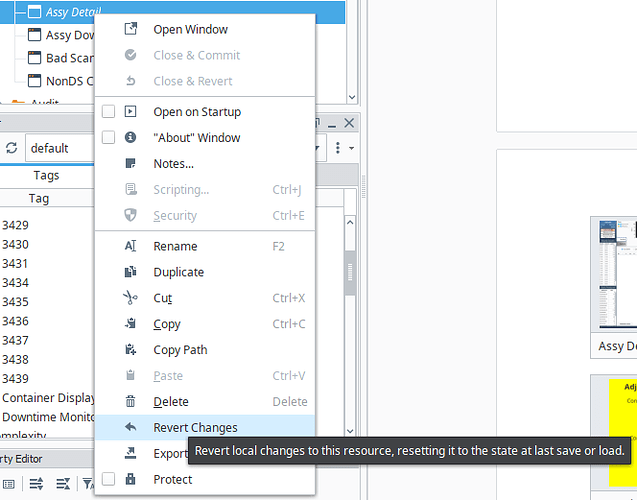

**Post date:** [February 3, 2022, 2:29pm UTC](https://forum.inductiveautomation.com/t/feature-request-ctrl-s-ctrl-shift-s-close-commit-changes-room-for-improvement/55701/8 "2022-02-03T14:29:23Z")
> [@pturmel](#):
> A way to individually revert resources to the gateway copy would be most helpful.
Committed windows do have a reversion option. Not quite grabbing it from the gateway, but close.

**Author:** ![bkarabinchak.psi](https://sea1.discourse-cdn.com/inductiveautomation/user_avatar/forum.inductiveautomation.com/bkarabinchak.psi/32/83567_2.png) [@bkarabinchak.psi](https://forum.inductiveautomation.com/u/bkarabinchak.psi)\
**Post date:** [February 3, 2022, 3:41pm UTC](https://forum.inductiveautomation.com/t/feature-request-ctrl-s-ctrl-shift-s-close-commit-changes-room-for-improvement/55701/10 "2022-02-03T15:41:56Z")
Wow how did I never know this existed. That helps a lot.
