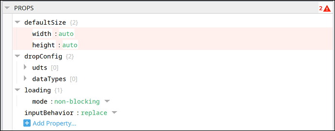

**Author:** ![Aiasa21](https://avatars.discourse-cdn.com/v4/letter/a/aeb1de/32.png) [@Aiasa21](https://forum.inductiveautomation.com/u/Aiasa21)\
**Post date:** [December 11, 2025, 1:41pm UTC](https://forum.inductiveautomation.com/t/fixed-chart-below-a-scrolling-wide-table/112752/3 "2025-12-11T13:41:11Z")
Thanks for the answer, it works.
In addition to your suggestions I also set the width and height size of the view to auto.
