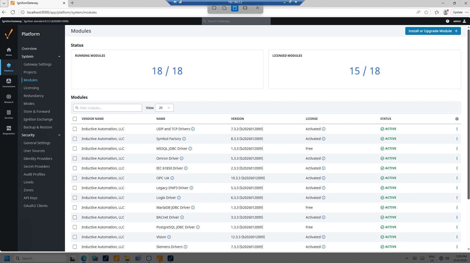

Hi Ignition Team, as stated in the title, I encounter this bug with no solutions, would be great if someone could help me point out this issue as I am not sure what went wrong.
Thank you for your assistance!
**Post date:** [June 9, 2026, 12:13pm UTC](https://forum.inductiveautomation.com/t/flashing-trial-expired-symbols-in-ignition-8-3-even-with-license-applied/115898/2 "2026-06-09T12:13:07Z")
Are you sure all of the modules you are using are listed in the license? That is, is your license **complete**?
**Author:** ![Sfenwick](https://sea1.discourse-cdn.com/inductiveautomation/user_avatar/forum.inductiveautomation.com/sfenwick/32/82355_2.png) [@Sfenwick](https://forum.inductiveautomation.com/u/Sfenwick)\
**Post date:** [June 9, 2026, 2:10pm UTC](https://forum.inductiveautomation.com/t/flashing-trial-expired-symbols-in-ignition-8-3-even-with-license-applied/115898/3 "2026-06-09T14:10:15Z")
Along with Phil's suggestion, check the module page of the gateway in question while you're at it. There's likely going to be a trial banner and it'll show you which modules are included.
**Author:** ![NoahChan](https://avatars.discourse-cdn.com/v4/letter/n/47e85d/32.png) [@NoahChan](https://forum.inductiveautomation.com/u/NoahChan)\
**Post date:** [June 10, 2026, 7:24am UTC](https://forum.inductiveautomation.com/t/flashing-trial-expired-symbols-in-ignition-8-3-even-with-license-applied/115898/4 "2026-06-10T07:24:13Z")
Hi Ignition Team, thank you for your response
 ![Modules 1](https://us1.discourse-cdn.com/inductiveautomation/original/3X/d/f/df8095b75779c28bc3d55a3b85dd4ebbd5e310fe.jpeg)
 ![Modules 2](https://us1.discourse-cdn.com/inductiveautomation/original/3X/c/0/c0238815288f0a80633981fa079c0fd2cf8d3249.jpeg)
We ran into this exact issue before and successfully resolved it by removing the unlicensed modules. However, looking at our current active module list, everything is fully licensed, yet the trial expiration behavior has returned.
**Post date:** [June 10, 2026, 11:37am UTC](https://forum.inductiveautomation.com/t/flashing-trial-expired-symbols-in-ignition-8-3-even-with-license-applied/115898/5 "2026-06-10T11:37:08Z")
Hmmm. Try upgrading to 8.3.6 from your current 8.3.3.

Did the views get saved while in trial mode at dinner point and never modified after getting a license? I'm wondering if there's some sort of persistence of the overlays that loads prior to live data causing it. I'd try opening and saving a few to see if it fixes it.
**Post date:** [June 11, 2026, 8:45am UTC](https://forum.inductiveautomation.com/t/flashing-trial-expired-symbols-in-ignition-8-3-even-with-license-applied/115898/7 "2026-06-11T08:45:10Z")
Alright thank you for the suggestion, I have updated the Ignition to 8.3.7
Bad news is, the flashing still appears after the update, which kinda worried me.
After reopening the Vision Client Application, it disappeared, so I'm not sure if the issue is considered fix? Hopefully it doesn't happen again
