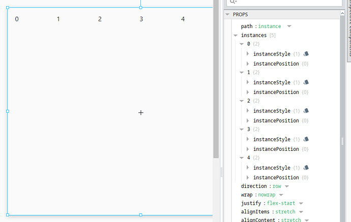

Flex repeater children will also automatically be sent an `index` parameter - just have a named input parameter `index` on your view, and it’ll automatically be supplied an index by the flex repeater:
 ![image](https://us1.discourse-cdn.com/inductiveautomation/original/2X/c/cf7689e2d20d07bf55b2b25cf8b99684ad5fd22b.png)
