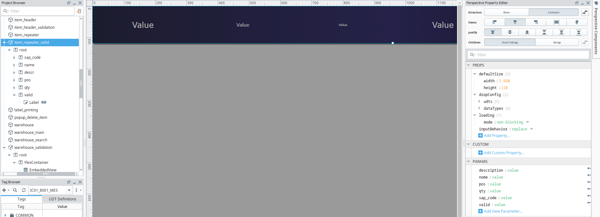

Hello
I’m going crazy on a flex repeater populated with query binding
this is the query:
```python
select
	l.sap_code,
	w.nome,
	w.description,
	l.validated_on "valid" ,
	w.qty ,
	w.pos
from
	wl_warehouse_log l
inner join wm_warehouse_masterdata w on
	w.sap_code = l.sap_code
where
	l.created_on::date = :data
this is the repeater
 ![image](https://us1.discourse-cdn.com/inductiveautomation/original/3X/2/6/262b1ab4b7794ac103d972f005f7ad6feb3f8b36.png)
as you can see the column valid is reflected in the repeater and moreover is also used as a condition in another field which is working properly
When the flex repeater is filled the column valid is correctly populated "(column VALIDATO) but in the instances there is no trace of “valid”. See below
 ![image](https://us1.discourse-cdn.com/inductiveautomation/original/3X/7/0/702930e22112876ba4ebe3e80a6499805713bc89.jpeg)
so as soon as I run a script on the flex repeater the attribute valid is not found
I’m running a change script on the flex repeater which is the following one:
```python
insta = self.props.instances
cond = True
for ix in insta:
	if ix.valid:
		cond = False
	else:
		cond = True
self.view.custom.valid = cond
This is the error
```python
Error running property change script on FlexRepeater.props.instances: Traceback (most recent call last): File "<function:valueChanged>", line 5, in valueChanged AttributeError: 'com.inductiveautomation.perspective.gateway.script' object has no attribute 'valid'
Can someone please tell me where I’m wrong?
Thanks
**Post date:** [September 12, 2025, 3:26pm UTC](https://forum.inductiveautomation.com/t/flex-repeater-on-query-binding-not-working-properly/110582/2 "2025-09-12T15:26:20Z")
> [@Francesco\_Vittadini](#):
> `	if ix.valid:`
Your instances don't have a `valid` property.
EDIT:
Because
`	l.validated_on "valid" ,`
is not valid SQL syntax. Try:
`	l.validated_on as "valid" ,`

Adding that as soon as I change the query in the binding ,for example adding new column .. the column are correctly shown until I run the page in demo mode

Hello Paul
tried but nope
 ![image](https://us1.discourse-cdn.com/inductiveautomation/original/3X/9/9/9921c25094829cb2ac7ad95d430d37bdc2412237.jpeg)
I’ve also added column row\_id which is also not appearing

Solved … I deleted the flex repeater and did a new one ….
Some weird behaviour
Thanks
