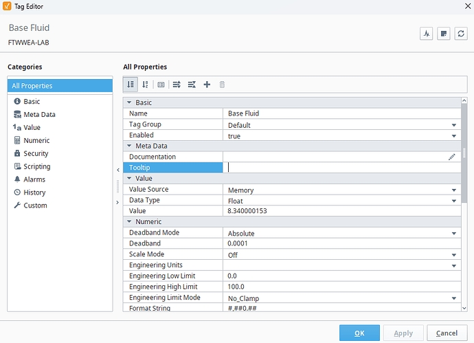

I have a brand new Memory Tag that is attached to nothing. I have manually typed a Float Value of 8.34 into the Value field and it keeps changing to 8.340000153. Additionally, I created a second tag with an entered value of 12.8 & it updates to 12.800000191. Does anyone have an idea what could cause this? As I mentioned it’s attached to no other tags & its a test tag I created just now. Ignition Version 8.1.39
 ![image](https://us1.discourse-cdn.com/inductiveautomation/original/3X/f/8/f8e95595a4707dde18544fbb4ae582c266b1c603.png)
 ![image](https://us1.discourse-cdn.com/inductiveautomation/original/3X/7/0/70444c411dcb79aa8963d3e832ca246e6bed5bde.png)
**Post date:** [September 3, 2025, 10:04pm UTC](https://forum.inductiveautomation.com/t/float-value-appends-data-to-the-end/110366/2 "2025-09-03T22:04:03Z")
> **[IEEE-754 Floating Point Converter](https://www.h-schmidt.net/FloatConverter/IEEE754.html)**
Type in 8.34 and see what you get.
**Post date:** [September 3, 2025, 10:06pm UTC](https://forum.inductiveautomation.com/t/float-value-appends-data-to-the-end/110366/3 "2025-09-03T22:06:29Z")
See also, [Numeric text field does not display what the value set to - #4 by pturmel](https://forum.inductiveautomation.com/t/numeric-text-field-does-not-display-what-the-value-set-to/72502/4).

Changing from Float to a Double seems to have fixed the issue with the additional numbers at the end.

It doesn't fix it, it only pushes it further.
If you're not doing float arithmetic, this quirk in IEEE-754 shouldn't matter, especially if you only need 2 decimals precision. Just format your numbers to show only 2 digits after the dot.
If you're dealing with currencies, or anything else that needs exact precision, use 2 integers instead of a float, one for the integral part, one for the decimals.
