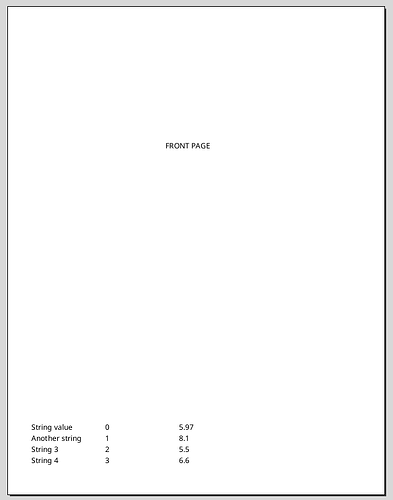

What I would like to happen is the second half of the table that appears on page 2 shows up at the top of the page 2 and the text “FRONT PAGE” only shows on the actual first page of the report.
Not quite sure of the steps to do this - I tried several things with tablegroups but haven’t stumbled upon the answer.
I appreciate any guidance / help here.

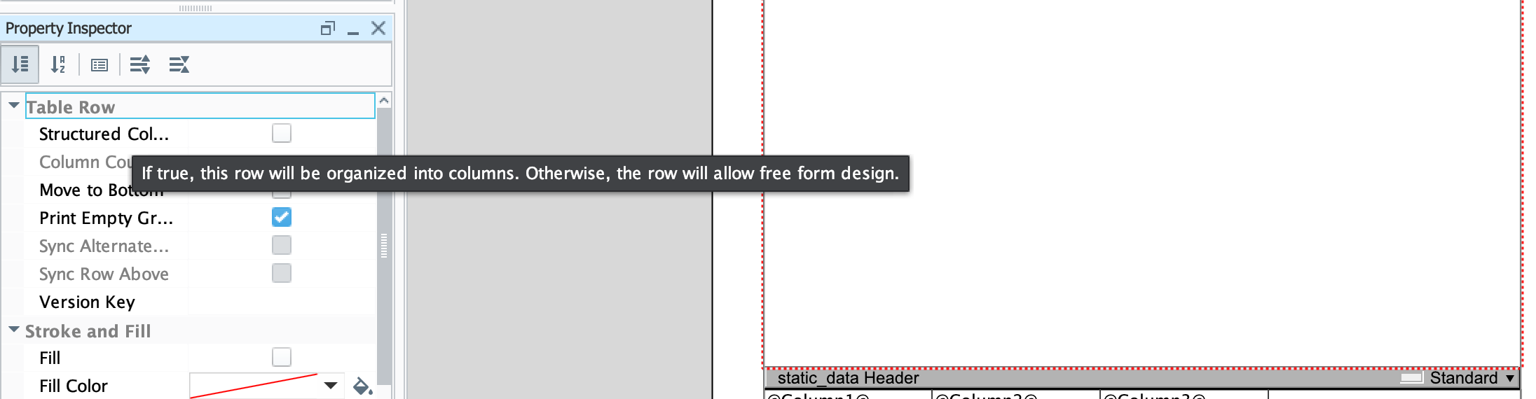

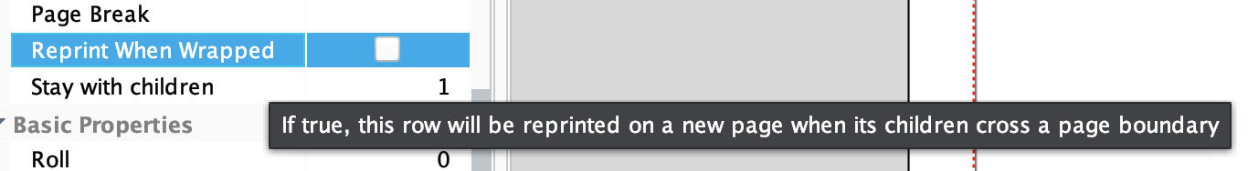

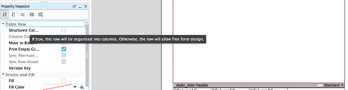

**Post date:** [September 12, 2025, 10:54pm UTC](https://forum.inductiveautomation.com/t/force-a-report-table-to-appear-on-a-second-page/110594/4 "2025-09-12T22:54:51Z")
1. Make the table the full size of the page.
2. Add a 'Header' row to the table, and make it "unstructured".
3. Add your `FRONT PAGE` content into that header, and ensure the header is _not_ set to "Reprint when wrapped".
 ![image](https://us1.discourse-cdn.com/inductiveautomation/original/3X/9/f/9fd489a25b1fed35c360b43fa379176ce2f8a5ad.png) ![image](https://us1.discourse-cdn.com/inductiveautomation/original/3X/5/b/5bdd47441999224f1e1936cfe7fe2b3356a677a4.png)
