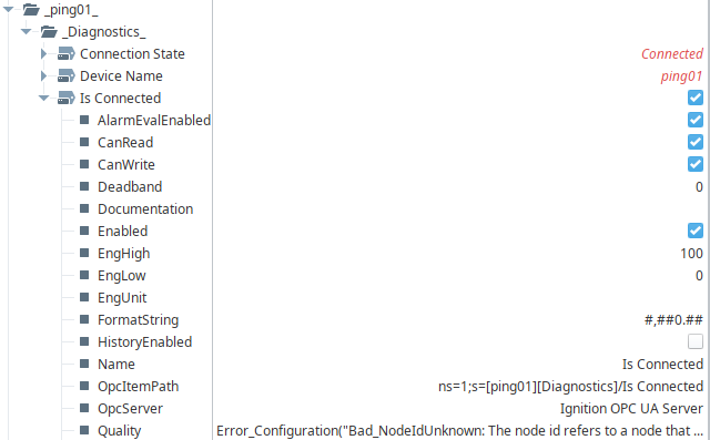

I have a driver module. It implements the **Device**
When I disable the device or delete the device, I would like to pass all tags to BAD Quality and to set valeur of Boolean tags to False ou Integer tags to 0.
I don’t find How I can find the BuiltinDataType from item.getReadValueId() or from node.getUaVariableNode() to adjust the right value

**Post date:** [September 1, 2025, 1:25pm UTC](https://forum.inductiveautomation.com/t/force-ignition-tag-to-bad-quality-and-null-or-false-value/110308/2 "2025-09-01T13:25:42Z")
`UaVariableNode::getDataType` returns the `NodeId` of the DataType.
You can compare that to `BuiltinDataType.Boolean.getNodeId()` or use `BuiltinDataType.fromNodeId` on the DataType and compare directly against `BuiltinDataType.Boolean`.
FWIW, in terms of OPC UA compliance, it is not allowed that a value accompanies a bad severity StatusCode in a DataValue. You must use something like `Uncertain_LastUsableValue` like we do.
**Author:** ![mazeyrat](https://sea1.discourse-cdn.com/inductiveautomation/user_avatar/forum.inductiveautomation.com/mazeyrat/32/10955_2.png) [@mazeyrat](https://forum.inductiveautomation.com/u/mazeyrat)\
**Post date:** [September 1, 2025, 2:51pm UTC](https://forum.inductiveautomation.com/t/force-ignition-tag-to-bad-quality-and-null-or-false-value/110308/3 "2025-09-01T14:51:13Z")
![image](https://us1.discourse-cdn.com/inductiveautomation/original/3X/b/1/b1204854b99c40eb2eff1484fe96879740502d13.png)
@Kevin.Herron What is a bit annoying in Designer is the boolean apparence. We don’t have any “red” alert for an invalid quality like for tag other type.
If it was possible to have the checkbox border red if tag quality is not Good…
**Post date:** [September 1, 2025, 2:59pm UTC](https://forum.inductiveautomation.com/t/force-ignition-tag-to-bad-quality-and-null-or-false-value/110308/4 "2025-09-01T14:59:20Z")
I opened a ticket about that 4 years ago 🙃
