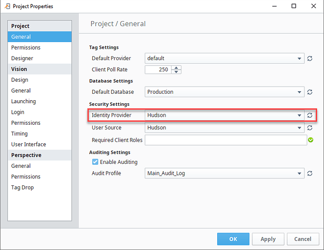

Hi
I try to force perspective to show login screen at startup by adding system.perspective.login() in session startup script but it cause loading page freeze.
How can I achieve this in perspective? I don’t want any public access at all.
**Post date:** [March 14, 2020, 11:26am UTC](https://forum.inductiveautomation.com/t/force-perspective-to-show-login-screen-at-startup/33089/2 "2020-03-14T11:26:13Z")
These settings in the project properties worked for me. No startup script.
 ![2020-03-14_7-21-53](https://us1.discourse-cdn.com/inductiveautomation/original/2X/0/0f688646b64271ed9f2ac7af3e79f4bd2e7e1d88.png)
