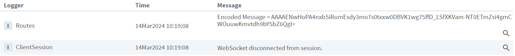

**Author:** ![Christian\_de\_Bellefe](https://avatars.discourse-cdn.com/v4/letter/c/e9c0ed/32.png) [@Christian\_de\_Bellefe](https://forum.inductiveautomation.com/u/Christian_de_Bellefe)\
**Post date:** [March 14, 2024, 2:50pm UTC](https://forum.inductiveautomation.com/t/force-refresh-on-perspective-mobile-doesnt-work/87214/3 "2024-03-14T14:50:41Z")
you are right. In development i know that i did some changes in the DB but in production, it should check periodically for new data so it should be tied to a name query with a polling period. So i'll stick with this method and forget about the swipe. So we can consider this case closed.
But just for curiosity, i've tested to put the script on the event onStartup of the **View** and tested the Swipe Down + 2 sec old. I've added a line which should put an entry "Mobile Refreshing" on the gateway log. I see this "Mobile Refreshing" on our log only on the first page load.
Swipe down + 2 sec hold doesn't add any line to the log except these:
 ![Ignition Gateway Log](https://us1.discourse-cdn.com/inductiveautomation/original/3X/0/2/029657ddd469e5e5454311f6f045de699eb128e9.png)
I've tried to refresh (F5, or CTRL-F5) the same app on Google Chrome on a PC, and it doesn't fire the onStartup event too.
**Author:** ![cmallonee](https://sea1.discourse-cdn.com/inductiveautomation/user_avatar/forum.inductiveautomation.com/cmallonee/32/6416_2.png) [@cmallonee](https://forum.inductiveautomation.com/u/cmallonee)\
**Post date:** [March 14, 2024, 3:35pm UTC](https://forum.inductiveautomation.com/t/force-refresh-on-perspective-mobile-doesnt-work/87214/4 "2024-03-14T15:35:20Z")
I kind of suspected it wouldn't. The View isn't technically "starting up" again; from the Gateway's point-of-view the View was always part of the Page - there was just a network hiccup.
