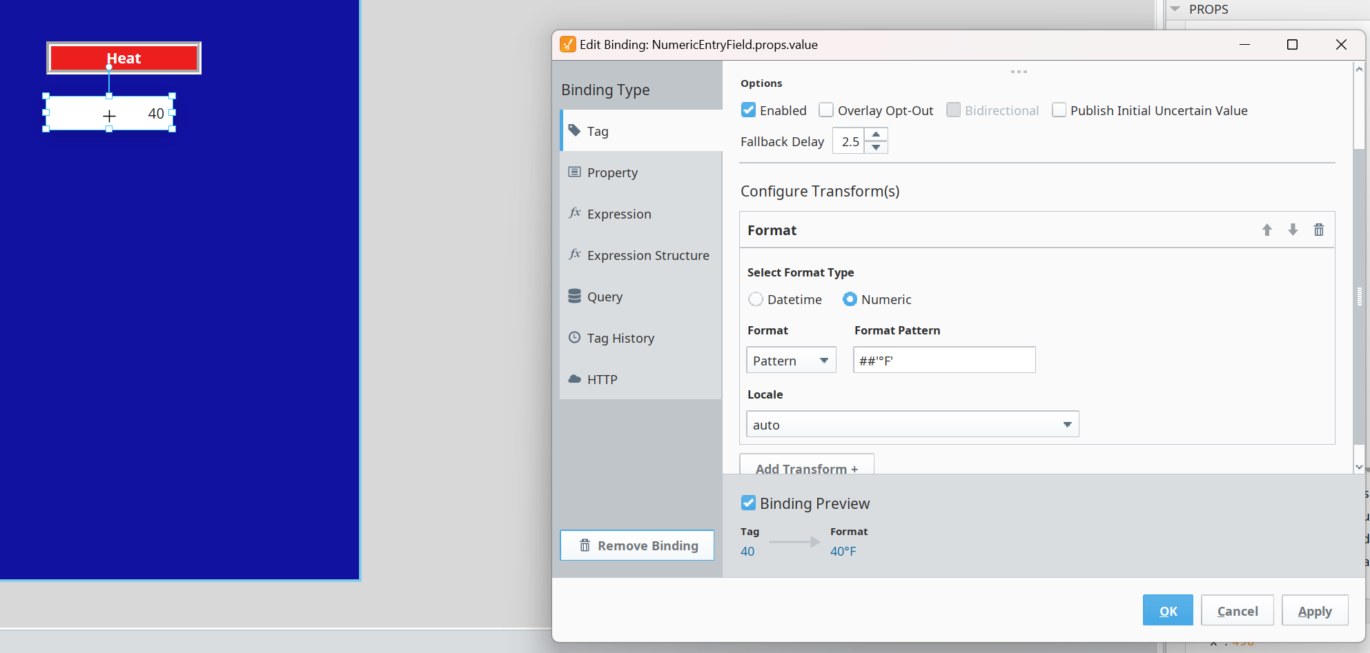

Hello, I am wondering why my °F is not showing when I believe I did the transform correct, thank you in advance anyone.
 ![Capture](https://us1.discourse-cdn.com/inductiveautomation/original/3X/d/9/d9a72b84423f646c8dd7176b6e46a62b18e03d60.png)

This is a numeric entry field component, if you want the **F** use a label
**Post date:** [March 14, 2025, 5:32pm UTC](https://forum.inductiveautomation.com/t/format-transform-f/103719/3 "2025-03-14T17:32:24Z")
Because you're using a Numeric Entry field.
The best approach, both from a UI/UX point of view and also for performance would be to just use a label next to the NumericEntryField to display the units. This way, you're not locked in to just a single unit, you don't have to worry about text alignment issues based on the size of the value, and you don't have to pay the cost of the transform.
