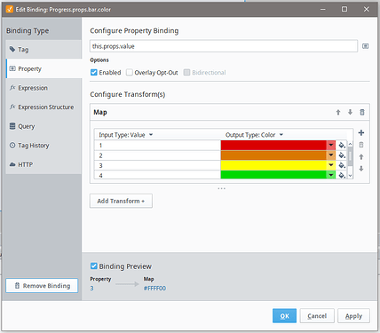

**Post date:** [February 15, 2024, 7:36pm UTC](https://forum.inductiveautomation.com/t/format-transform/85715/4 "2024-02-15T19:36:39Z")
Sure.
1. Set `Progress.props.max` to 4
2. Configure a property binding to `Progress.props.value` on `Progress.props.bar.color`
3. Add a map transform to the binding.
4. Set the Output Type of the transform to Color
5. Add mappings for your various colors.
 ![image](https://us1.discourse-cdn.com/inductiveautomation/original/3X/8/f/8fddbfcadf5c91c922ea525ccae4bd2277a03c37.png)
Sample:
![progress](https://us1.discourse-cdn.com/inductiveautomation/original/3X/4/d/4d39de309923e19e794361af567784d0c9cc7e56.gif)
