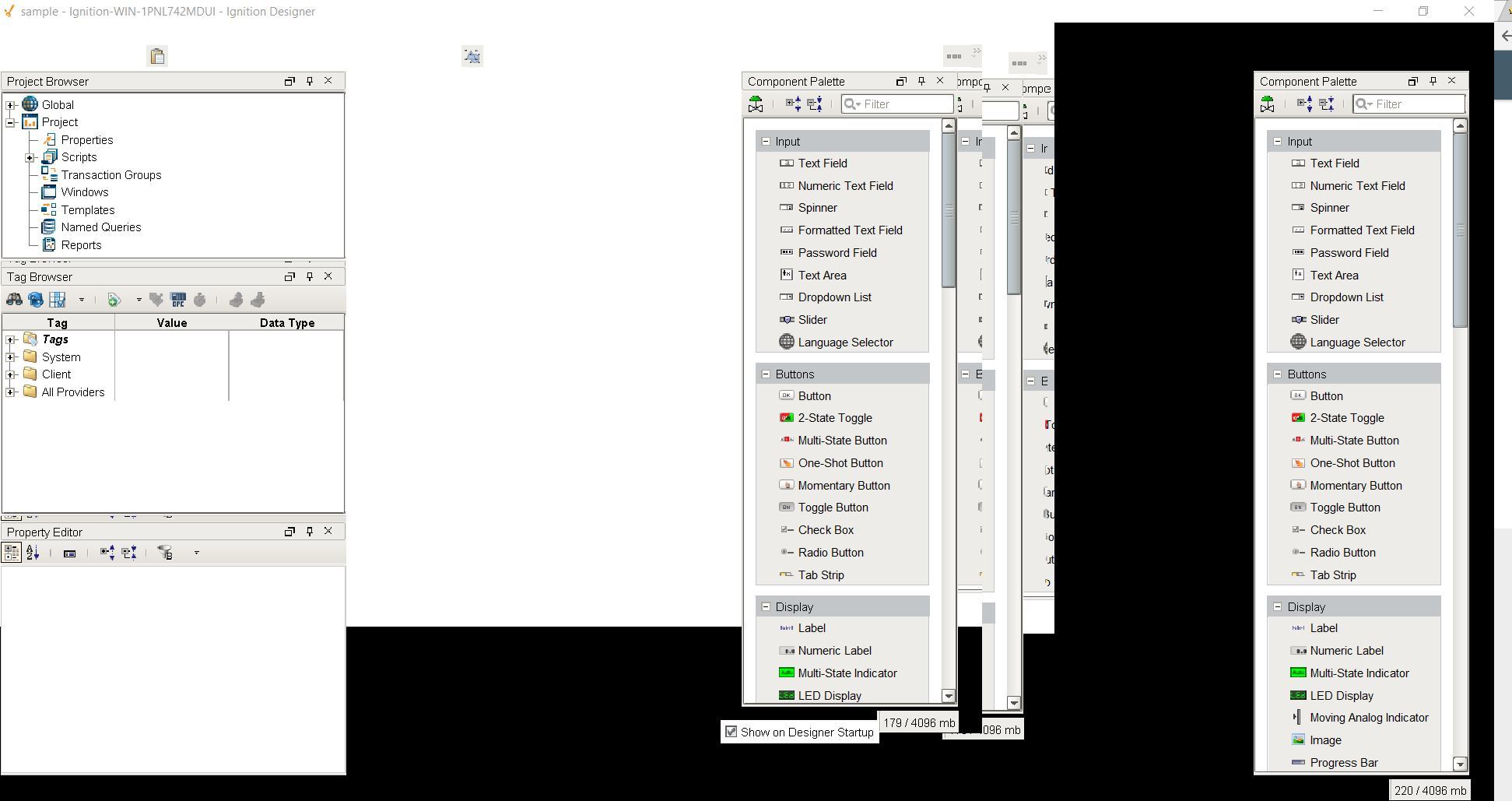

Hi Everyone,
I have an issue while maximizing the window size. I changed the memory allocation for designer in the settings on the Ignition gateway. Is there a way to resolve this?.
I am using multiple displays and also tried with primary display (laptop). Still the same issue.
 ![](https://us1.discourse-cdn.com/inductiveautomation/original/2X/2/2951208cc7c1c4cb6865f29a6cff4e5d57ac369f.JPG)
**Author:** ![kartithamizhchelvan](https://avatars.discourse-cdn.com/v4/letter/k/3ec8ea/32.png) [@kartithamizhchelvan](https://forum.inductiveautomation.com/u/kartithamizhchelvan)\
**Post date:** [August 9, 2018, 12:26am UTC](https://forum.inductiveautomation.com/t/full-window-mode-designer/19159/2 "2018-08-09T00:26:52Z")
This is resolved. Need to change Java Heap size. I set it to 3 GB.
“-Xms3072m” add this parameter to the Java Runtime Parameter.
