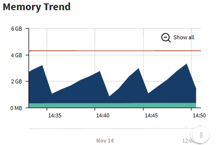

I now have 8GB allocated to the VM and 4GB to ignition. Something I'm seeing now that has me confused is the lack of correlation between the memory gauge(?) and the memory trend.
**Data from jstat:**
 ![image](https://us1.discourse-cdn.com/inductiveautomation/original/3X/0/c/0cc9d605f133adcaf632f49e110f3418905925c8.png)
From Gateway Web Interface:\*\*
 ![image](https://us1.discourse-cdn.com/inductiveautomation/original/3X/7/a/7a7d91fe8d3ed612dfb73eb152451114281c86db.png)
As you can see, between 14:40:00 and 14:43:30 (from jstat data), there are 5 collections, whereas in the memory trend in gateway web interface, I'm only seeing one collection occuring within that timeframe. Are these not the same metric?
