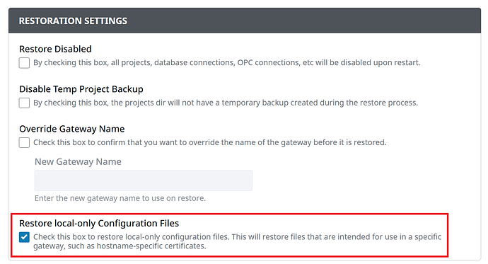

Actually it does dispatch local-only data to the redundant backup, but you have to enable this option on restore:
 ![image](https://us1.discourse-cdn.com/inductiveautomation/original/3X/3/5/357d8edf14f815353a6f5c89e7aaeb720b397191.png)
The idea is that the redundant master retrieves local-specific files (such as host-specific certificates) from both redundant gateways and saves both in the .gwbk. Then the local-only files can be restored to each correct gateway upon restore (if that checkbox is checked).
