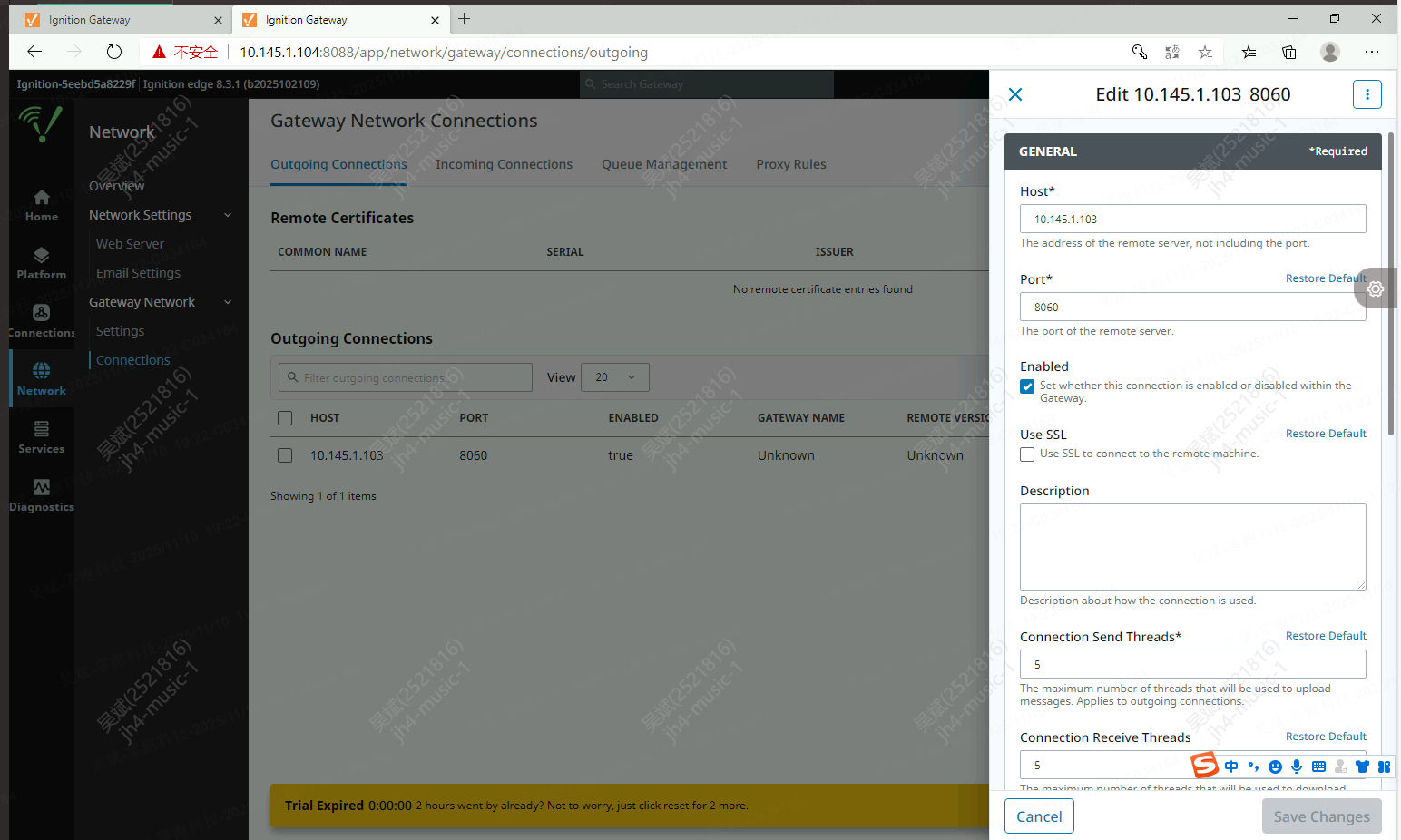

Hello everyone,
I encountered the following error while configuring a gateway connection. Both virtual machines are running on the same physical host, so theoretically, traffic between them shouldn't pass through a firewall. This is the first time I've run into this issue—what should I do next?
```python
Connection attempt to 'ws://10.145.1.103:8060/system/ws-control-servlet?name=ignition-5eebd5a8229f-master&uuid=2b058902-0e5f-40e1-9f4d-d811b7301602&serializer=protobuf&url=http://10.145.1.104:8088/system' failed!
Response code='400', error message='org.eclipse.jetty.websocket.api.exceptions.UpgradeException: org.eclipse.jetty.websocket.core.exception.UpgradeException: 400 Illegal character CNTL=0x15'.

**Author:** ![Senthee\_Wu](https://sea1.discourse-cdn.com/inductiveautomation/user_avatar/forum.inductiveautomation.com/senthee_wu/32/67770_2.png) [@Senthee\_Wu](https://forum.inductiveautomation.com/u/Senthee_Wu)\
**Post date:** [November 10, 2025, 11:23am UTC](https://forum.inductiveautomation.com/t/gateway-connection-error/112067/3 "2025-11-10T11:23:22Z")
I checked and didn't find any spaces.
 ![image](https://us1.discourse-cdn.com/inductiveautomation/original/3X/7/9/790351f55b036bc7220bc8b9d62bda08646af1a1.png)
 ![image](https://us1.discourse-cdn.com/inductiveautomation/original/3X/5/d/5d22d6687126de1b0211ef49f9f03b1aaf91d270.png)
 ![image](https://us1.discourse-cdn.com/inductiveautomation/original/3X/b/4/b44430fa3aafff55a8607a43f917ee0cac88bfe6.png)

**Author:** ![mgross](https://sea1.discourse-cdn.com/inductiveautomation/user_avatar/forum.inductiveautomation.com/mgross/32/3311_2.png) [@mgross](https://forum.inductiveautomation.com/u/mgross)\
**Post date:** [November 10, 2025, 2:06pm UTC](https://forum.inductiveautomation.com/t/gateway-connection-error/112067/5 "2025-11-10T14:06:21Z")
Port 8060 can only be used for gateway network SSL connections. You have to check the “Use SSL” checkbox in your connection settings.
