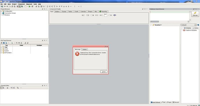

I have de-install completly ignition and re-nstall the 7.2.9-beta5 (b197)
I create a fresh new project
when I launch the designer i have the error : gateway error 304 : unable to fin the default datasource ?
No specific configuration :
Realtime SQLTags Providers :
default Internal Provider Built-in SQLTags provider
How solve this error ?
 ![](https://us1.discourse-cdn.com/inductiveautomation/original/1X/8c51d68f09991f1a7e75dea26aa2f98a5cb54342.jpg)
**Author:** ![mazeyrat](https://sea1.discourse-cdn.com/inductiveautomation/user_avatar/forum.inductiveautomation.com/mazeyrat/32/10955_2.png) [@mazeyrat](https://forum.inductiveautomation.com/u/mazeyrat)\
**Post date:** [September 23, 2011, 7:27pm UTC](https://forum.inductiveautomation.com/t/gateway-error-304-unable-to-fin-the-default-datasource/3328/2 "2011-09-23T19:27:07Z")
i clause the query browser and it’s ok
**Author:** ![Colby.Clegg](https://sea1.discourse-cdn.com/inductiveautomation/user_avatar/forum.inductiveautomation.com/colby.clegg/32/3282_2.png) [@Colby.Clegg](https://forum.inductiveautomation.com/u/Colby.Clegg)\
**Post date:** [September 23, 2011, 8:29pm UTC](https://forum.inductiveautomation.com/t/gateway-error-304-unable-to-fin-the-default-datasource/3328/3 "2011-09-23T20:29:09Z")
Yes, the query browser tries to first use the “default” datasource, and the project doesn’t have a default. You can set the project’s default datasource in the gateway, by going to Configuration\>Projects.
