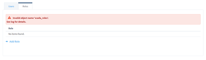

I am trying to map all authentication info about users and roles from a database user source to a Microsft SQL Server database following this guide [Database Authentication](https://docs.inductiveautomation.com/display/DOC80/Database+Authentication). I have configured it successfully using SQLite Database. However, when I tried to create a role or a user in a user source using Microsoft SQL Server Database, it triggered some errors. You can see them in the figures below.

In addition, I am using SQL Authentication instead of Window Authentication to connect to the SQL Server.
**Post date:** [November 6, 2021, 4:32pm UTC](https://forum.inductiveautomation.com/t/gateway-error-when-storing-authentication-info-to-microsoft-sql-server-database/52803/3 "2021-11-06T16:32:39Z")
The queries you defined for this profile may need to have the schema name prefixing the table names for SQL Server.
**Author:** ![phandc](https://avatars.discourse-cdn.com/v4/letter/p/ce73a5/32.png) [@phandc](https://forum.inductiveautomation.com/u/phandc)\
**Post date:** [November 6, 2021, 5:06pm UTC](https://forum.inductiveautomation.com/t/gateway-error-when-storing-authentication-info-to-microsoft-sql-server-database/52803/4 "2021-11-06T17:06:10Z")
Thanks for your support.
I hope Ignition can manage all authentication info. Therefore, I chose Automatic Mode when I created a user source. I can query data from the same SQL DB in Designer.
 ![image](https://us1.discourse-cdn.com/inductiveautomation/original/3X/b/0/b00f310432deaf6e20965f784512fa9068cc724c.png)
The error occurred when I want to create some tables to that database.
**Post date:** [December 2, 2021, 11:10am UTC](https://forum.inductiveautomation.com/t/gateway-error-when-storing-authentication-info-to-microsoft-sql-server-database/52803/5 "2021-12-02T11:10:48Z")
@Kevin.Herron I came back to this topic after several days. Finally, I got the answer. I found that because the SQL Authentication account did not have permission to create databases and tables. Therefore, when I chose the automatic mode to create some user/role tables, it triggered the error as I mentioned above. Changing the permission of SQL Authen account helped me solve the problem.
