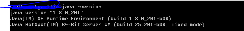

Hi,
I get my gateway faulted, but I tried to reinstall Ignition from scratch multiple times,but it doesn’t resolve the issue.
Here is the log :

What version (8, 9) and distribution (Oracle, OpenJDK, Azul) of Java are you using? What OS are you on?
**Author:** ![guillaume.collin](https://avatars.discourse-cdn.com/v4/letter/g/ee59a6/32.png) [@guillaume.collin](https://forum.inductiveautomation.com/u/guillaume.collin)\
**Post date:** [March 27, 2019, 5:41pm UTC](https://forum.inductiveautomation.com/t/gateway-is-faulted-7-9-10/23636/7 "2019-03-27T17:41:53Z")
![image](https://us1.discourse-cdn.com/inductiveautomation/original/2X/2/2c6f1359ad9251ae3e52fe47ccbbd7a4865bfd7c.png)
I got this
**Post date:** [March 27, 2019, 5:44pm UTC](https://forum.inductiveautomation.com/t/gateway-is-faulted-7-9-10/23636/8 "2019-03-27T17:44:05Z")
Ignition 7.9 does not run on Java versions higher than 9. You need to either downgrade your system Java, or specifically point Ignition to a lower version Java install, via the `ignition.conf` file.
**Post date:** [March 27, 2019, 6:16pm UTC](https://forum.inductiveautomation.com/t/gateway-is-faulted-7-9-10/23636/9 "2019-03-27T18:16:39Z")
![image](https://us1.discourse-cdn.com/inductiveautomation/original/2X/f/fc0072b4b4a41b194860daa9e246d51c049beaca.png)
Still having the gateway faulted
**Post date:** [March 27, 2019, 6:18pm UTC](https://forum.inductiveautomation.com/t/gateway-is-faulted-7-9-10/23636/10 "2019-03-27T18:18:58Z")
…what’s the error?

**Post date:** [March 27, 2019, 6:31pm UTC](https://forum.inductiveautomation.com/t/gateway-is-faulted-7-9-10/23636/13 "2019-03-27T18:31:17Z")
It doesn't look like you're using Java 8, still:
> INFO | jvm 1 | 2019/03/27 14:13:18 | OpenJDK 64-Bit Server VM warning: Option UseConcMarkSweepGC was deprecated in version 9.0 and will likely be removed in a future release.
Try hardcoding a path in ignition.conf: [Changing Gateway Java Version - Ignition User Manual 7.9 - Ignition Documentation](https://docs.inductiveautomation.com/display/DOC79/Changing+Gateway+Java+Version)
**Post date:** [March 27, 2019, 6:43pm UTC](https://forum.inductiveautomation.com/t/gateway-is-faulted-7-9-10/23636/14 "2019-03-27T18:43:20Z")
I restarted a second time my computer and it works now, thank you!
