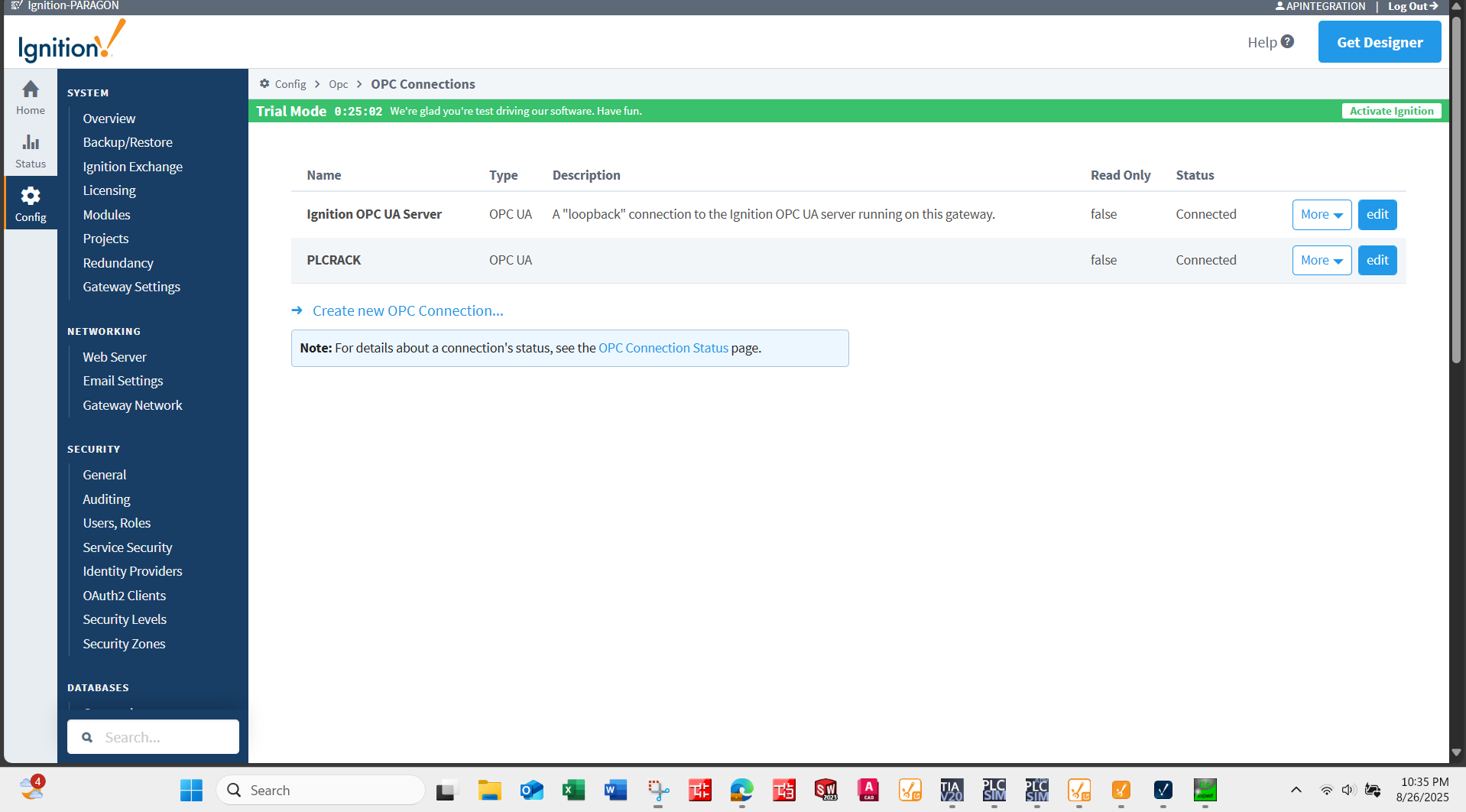

Today I’ve had it happen again and now I realize there’s an actual issue. Essentially my gateway is maintaining connectivity with the OPC server but not reading or writing anymore. I don’t get any connectivity problems on my HMI (I have a system bit monitoring connection with PLC, maintains “Connected”). I flip over to my gateway and check the connection, and it’s “connected”.

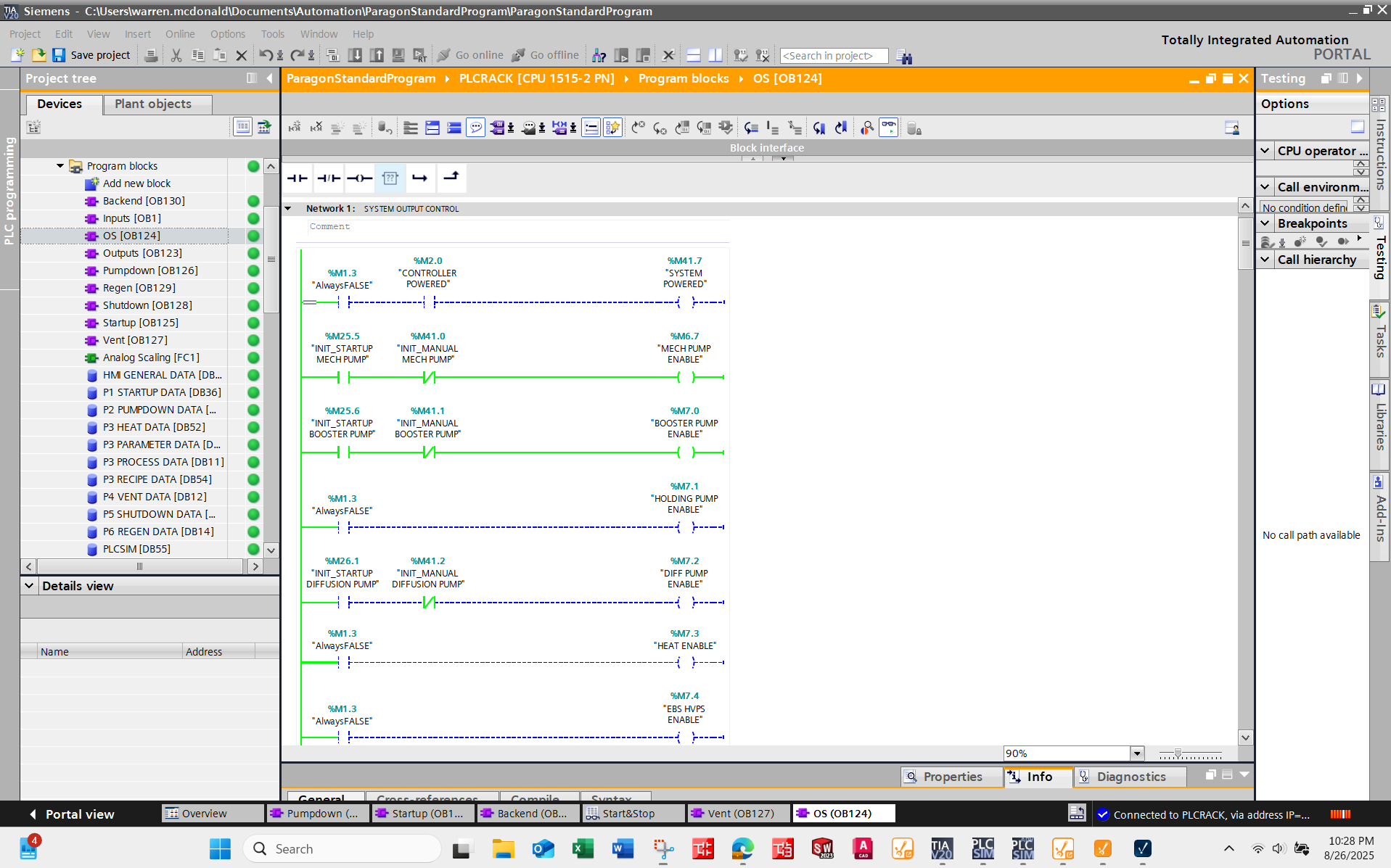

The pictures below show this. MECH PUMP/BOOSTER PUMP on PLC outputs are true, UAExpert sees this, HMI not showing true for the bottom right pumps. HMI showing “Connected’ in the top banner, left side.
 ![826_GATEWAY](https://us1.discourse-cdn.com/inductiveautomation/original/3X/5/0/50d77815e629df65394d96363374eb1e4b0c2873.png)

 ![826_UAE](https://us1.discourse-cdn.com/inductiveautomation/original/3X/b/5/b5333d64c83bcb5aa0e323bb49cad3543464c5bb.png)
