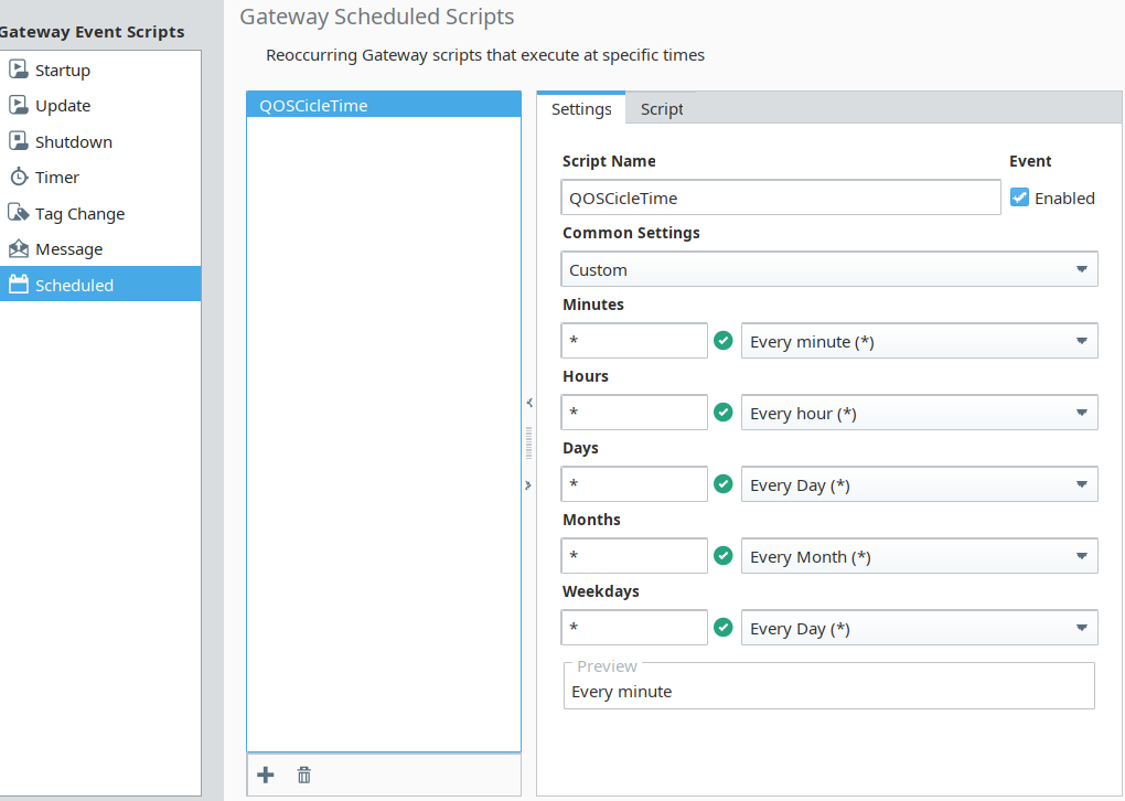

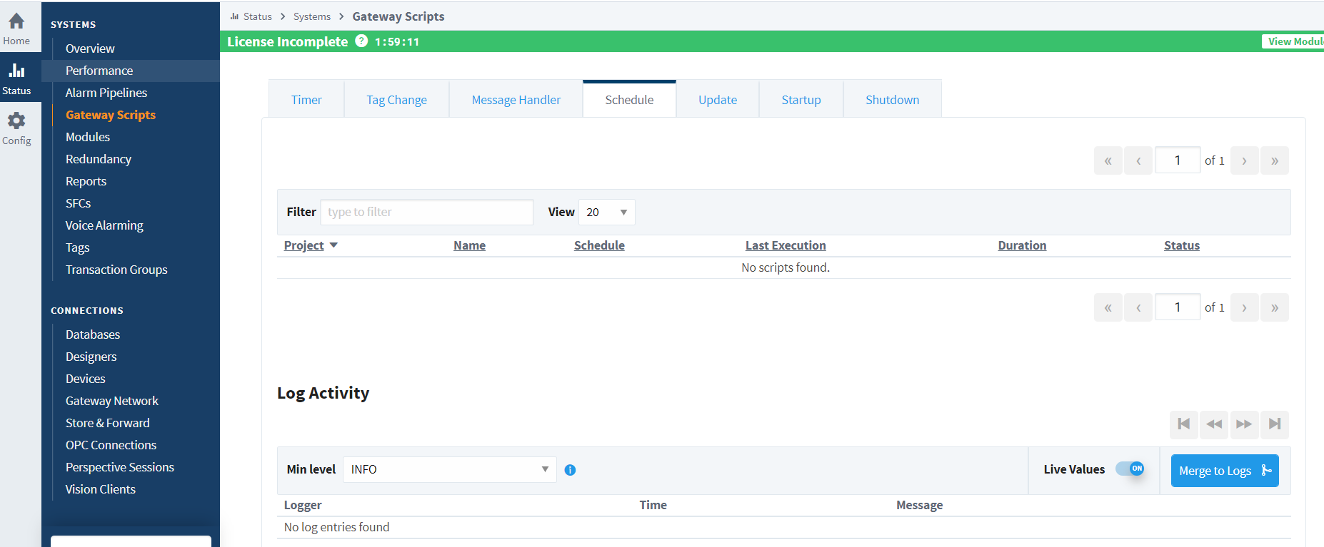

I see that on the gateway \> status \> gateway scripts the list is empty.
Tried to add a different gateway event (Timer), but the same output…
 ![3](https://us1.discourse-cdn.com/inductiveautomation/original/3X/e/9/e997d9a1922c253e7ada28a0b0d7bc6bd8d16d3c.png)
 ![2](https://us1.discourse-cdn.com/inductiveautomation/original/3X/5/b/5b1488c194eaf6cfe1a9ef045c823b444033a6d7.png)
 ![1](https://us1.discourse-cdn.com/inductiveautomation/original/3X/8/f/8f87f2d4bc82cbd942949356c97fef0fc902e986.png)

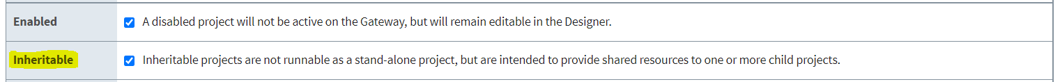

The problem in my case was:
In Ignition gateway are defined 2 projects : lib and production (production is inheriting lib)
I did my development in the lib project, which is **not runnable** as a stand-alone project. It will not create a Gateway Event by itself.
 ![4](https://us1.discourse-cdn.com/inductiveautomation/original/3X/e/4/e4aea7364b5f79eed87320806b0aaddad77104f3.png)
The production project was setup to override Gateway Events…
 ![5](https://us1.discourse-cdn.com/inductiveautomation/original/3X/8/0/80bb6a5e9efba59db796a6940b32ddc15993be58.png)
Thanks for the support guys.
