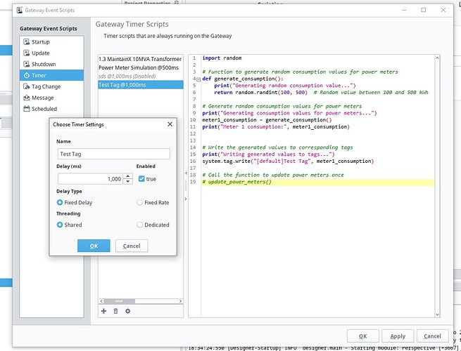

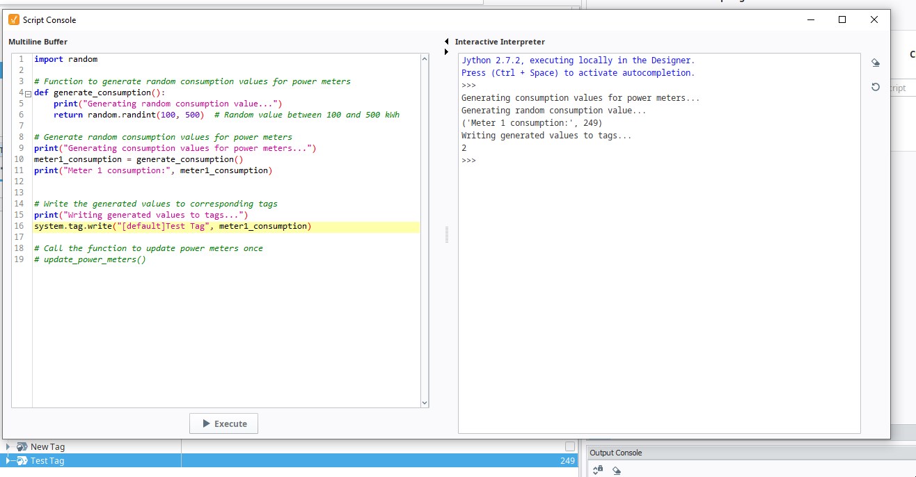

Good Afternoon,
I have a script where I would like it to generate a random number then pass it into a variable. However I am find that the tag is not updating.
I would like this to run under a timer (every 1 second) but I am not having any luck with this.
I do have other scripts running with tigger from timers and triggered from a tag change, and this works correctly when I put it in the script console.

**Post date:** [April 10, 2024, 11:38pm UTC](https://forum.inductiveautomation.com/t/gateway-script-not-triggering/88671/4 "2024-04-10T23:38:30Z")
> [@Ryan\_Crawford](#):
Can you share a screenshot of how you've got the timer script set up? Any errors in the gateway console? If you add logging statements with `system.util.getLogger`, are you seeing those output to confirm your script is actually running? Have you saved the project (gotta ask 😄)?
**Author:** ![Ryan\_Crawford](https://avatars.discourse-cdn.com/v4/letter/r/a587f6/32.png) [@Ryan\_Crawford](https://forum.inductiveautomation.com/u/Ryan_Crawford)\
**Post date:** [April 11, 2024, 1:46am UTC](https://forum.inductiveautomation.com/t/gateway-script-not-triggering/88671/5 "2024-04-11T01:46:25Z")
> [@paul-griffith](#):
Thanks for the resposne peter!
haha fair question, yes I have saved it... multiple times. And I cant see any errors in the consol output.
 ![CFKTN18p1O](https://us1.discourse-cdn.com/inductiveautomation/original/3X/3/b/3b3631aec9cdc7f785387db1c7a8f46a6c7759c9.jpeg)
 ![ysu1xfUZ7s](https://us1.discourse-cdn.com/inductiveautomation/original/3X/6/9/69315ff7d423fc6ce9e7e3b758dc8d4dfa3efbe5.jpeg)
**Post date:** [April 11, 2024, 1:57am UTC](https://forum.inductiveautomation.com/t/gateway-script-not-triggering/88671/6 "2024-04-11T01:57:23Z")
The errors won't be in the console. They will be in the gateway logs. Gateway events run in the gateway.
