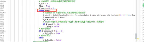

The code constructs that trigger this system-wide failure are:
a. The next() function used with a generator expression:
b. Even the use of while() function
 ![4](https://us1.discourse-cdn.com/inductiveautomation/original/3X/a/f/af2112761a5c6ec456a580284ebe46c048c1613b.png)
c. If we comment out these problematic sections of code and save the project, all Gateway Timer events immediately begin to run correctly again.
d. Important notes:
1. The issue is not caused by the execution of the problematic code, but by its mere presence in a project script library.
2. Our simple test event, which only called a basic system.tag.readBlocking() function, was made to fail simply because another function containing a next() or while construct existed in the same script library, even though that other function was never called.

You need to open a support ticket and supply all of this information to IA. (This forum is not official support, and is not the place for critical help.)
Your troubleshooting is valid, and has narrowed into a particularly bad programming practice: unbounded `while` loops in event scripts. Commenting them out fixes your problem because they are your problem. Event scripts should **never** wait on indefinite external conditions. Event scripts are expected to run to completion relatively quickly, deterministically.
Any functionality you have that needs to execute based on an external condition needs to be in a timer event, where the condition is checked just **once** per cycle, and the script exited early otherwise.
