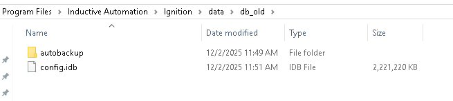

On our development server we’ve occasionally run into a situation where the Gateway memory usage climbs and does not get released. Restarting the Gateway usually clears this up and results in a significant reduction in memory usage. Otherwise, the memory can remain tied up for hours, or sometimes never gets released at all.
#### What I did to fix it
In the past, when I’ve run into similar issues, I was able to resolve them by restoring a **smaller** `config.idb` **file** from backup. That approach worked because the Gateway could initialize cleanly with a lighter database.
In this particular case, however, the available backups were actually **larger than the current file** , so restoring them didn’t help.
As a workaround, I renamed the existing `db` folder to `db_old` and restarted the Gateway. After doing this, the Gateway was able to start again. All Gateway configuration was lost, but importantly, all Designer project resources were preserved — which was the most critical aspect for us.
#### Error details
The following error appears in the `wrapper.log` when the Gateway fails to start:
> INFO | jvm 1 | 2025/12/02 11:39:47 | E [IgnitionGateway] [17:39:47]: Error during context startup. INFO | jvm 1 | 2025/12/02 11:39:47 | org.sqlite.SQLiteException: [SQLITE\_FULL] Insertion failed because database is full (database or disk is full) INFO | jvm 1 | 2025/12/02 11:39:47 | at org.sqlite.core.DB.newSQLException(DB.java:1179) INFO | jvm 1 | 2025/12/02 11:39:47 | at org.sqlite.core.DB.newSQLException(DB.java:1190) INFO | jvm 1 | 2025/12/02 11:39:47 | at org.sqlite.core.DB.throwex(DB.java:1150) INFO | jvm 1 | 2025/12/02 11:39:47 | at org.sqlite.core.NativeDB.\_exec\_utf8(Native Method) INFO | jvm 1 | 2025/12/02 11:39:47 | at org.sqlite.core.NativeDB.\_exec(NativeDB.java:93) INFO | jvm 1 | 2025/12/02 11:39:47 | at org.sqlite.jdbc3.JDBC3Statement.lambda$executeLargeUpdate$2(JDBC3Statement.java:128) INFO | jvm 1 | 2025/12/02 11:39:47 | at org.sqlite.jdbc3.JDBC3Statement.withConnectionTimeout(JDBC3Statement.java:454) INFO | jvm 1 | 2025/12/02 11:39:47 | at org.sqlite.jdbc3.JDBC3Statement.executeLargeUpdate(JDBC3Statement.java:115) INFO | jvm 1 | 2025/12/02 11:39:47 | at org.sqlite.jdbc3.JDBC3Statement.executeUpdate(JDBC3Statement.java:102) INFO | jvm 1 | 2025/12/02 11:39:47 | at com.inductiveautomation.ignition.gateway.localdb.AbstractDBInterface.runUpdateQuery(AbstractDBInterface.java:222) INFO | jvm 1 | 2025/12/02 11:39:47 | at com.inductiveautomation.ignition.gateway.localdb.AbstractDBInterface.runUpdateQuery(AbstractDBInterface.java:236) INFO | jvm 1 | 2025/12/02 11:39:47 | at com.inductiveautomation.ignition.gateway.IgnitionGateway.startupInternal(IgnitionGateway.java:1238) INFO | jvm 1 | 2025/12/02 11:39:47 | at com.inductiveautomation.ignition.gateway.redundancy.RedundancyManagerImpl.startup(RedundancyManagerImpl.java:301) INFO | jvm 1 | 2025/12/02 11:39:47 | at com.inductiveautomation.ignition.gateway.IgnitionGateway.initRedundancy(IgnitionGateway.java:759) INFO | jvm 1 | 2025/12/02 11:39:47 | at com.inductiveautomation.ignition.gateway.IgnitionGateway.lambda$initInternal$0(IgnitionGateway.java:693) INFO | jvm 1 | 2025/12/02 11:39:47 | at com.inductiveautomation.ignition.common.execution.impl.BasicExecutionEngine$ThrowableCatchingRunnable.run(BasicExecutionEngine.java:544) INFO | jvm 1 | 2025/12/02 11:39:47 | at java.base/java.util.concurrent.Executors$RunnableAdapter.call(Unknown Source) INFO | jvm 1 | 2025/12/02 11:39:47 | at java.base/java.util.concurrent.FutureTask.run(Unknown Source) INFO | jvm 1 | 2025/12/02 11:39:47 | at java.base/java.util.concurrent.ScheduledThreadPoolExecutor$ScheduledFutureTask.run(Unknown Source) INFO | jvm 1 | 2025/12/02 11:39:47 | at java.base/java.util.concurrent.ThreadPoolExecutor.runWorker(Unknown Source) INFO | jvm 1 | 2025/12/02 11:39:47 | at java.base/java.util.concurrent.ThreadPoolExecutor$Worker.run(Unknown Source) INFO | jvm 1 | 2025/12/02 11:39:47 | at java.base/java.lang.Thread.run(Unknown Source) INFO | jvm 1 | 2025/12/02 11:39:47 | I [IgnitionGateway] [17:39:47]: Ignition[state=STARTING] ContextState = FAULTED
**My questions**
1. Is there a better way to force Java / Ignition’s internal processes to release memory without requiring a full Gateway restart?
2. For this specific error, is there a reason why SQLite fails at around **2 GB** of file size on restart? Below is a screenshot of the file size that consistently causes the Gateway to fault on startup.
edit: Additional information
- Version: 8.1.36 (b2024010211)
- Gateway memory: 40,960
- The gateway memory is at 39/40 GBs, a restart would drop it to 15/40 and it would settle around 20/40 GBs after a few minutes
**Post date:** [December 2, 2025, 7:08pm UTC](https://forum.inductiveautomation.com/t/gateway-startup-fault-sqlite-sqlite-full-error/112574/2 "2025-12-02T19:08:25Z")
> [@jacque\_trahan](#):
This is an error that _most likely_ indicates a lack of physical disk space. Unrelated to anything with system memory (a full disk is going to be catastrophic for almost any software that needs to read and write files).
No. The JVM will automatically run garbage collection whenever it can (increasing in frequency/consuming more CPU resources as the memory approaches configure limits). You _can_ tune the garbage collection process with a variety of system flags, but it's not generally necessary or recommended. And frankly it sounds like your system is struggling for a variety of reasons, so any tweaking you do to system parameters is probably wasted effort.
As previously mentioned, the most likely cause of the SQLITE\_FULL error is a lack of physical disk space on the server overall - SQLite needs some extra headroom so that it can atomically perform file updates to minimize the risk of DB file corruption even in exceptional scenarios.
It's **definitely** not normal to have an internal database anywhere near 2gB. Especially if the things you care the most about are **projects** - typically large internal database files are full of lots and lots of tag configuration data.
I would **strongly** recommend you contact our support department officially, because any help we can offer asynchronously via the forums (on whatever information you can publicly provide) is going to be substantially less targeted than a support rep connecting to your system live and doing in depth troubleshooting.
If you can't/won't/don't want to do that, the next step I would undertake is getting the `sqlite_tools`, a package of programs to run on the command line, one of which, `sqlite_analyzer`, can tell you what exactly is taking up all that space in the 2gB IDB file.
