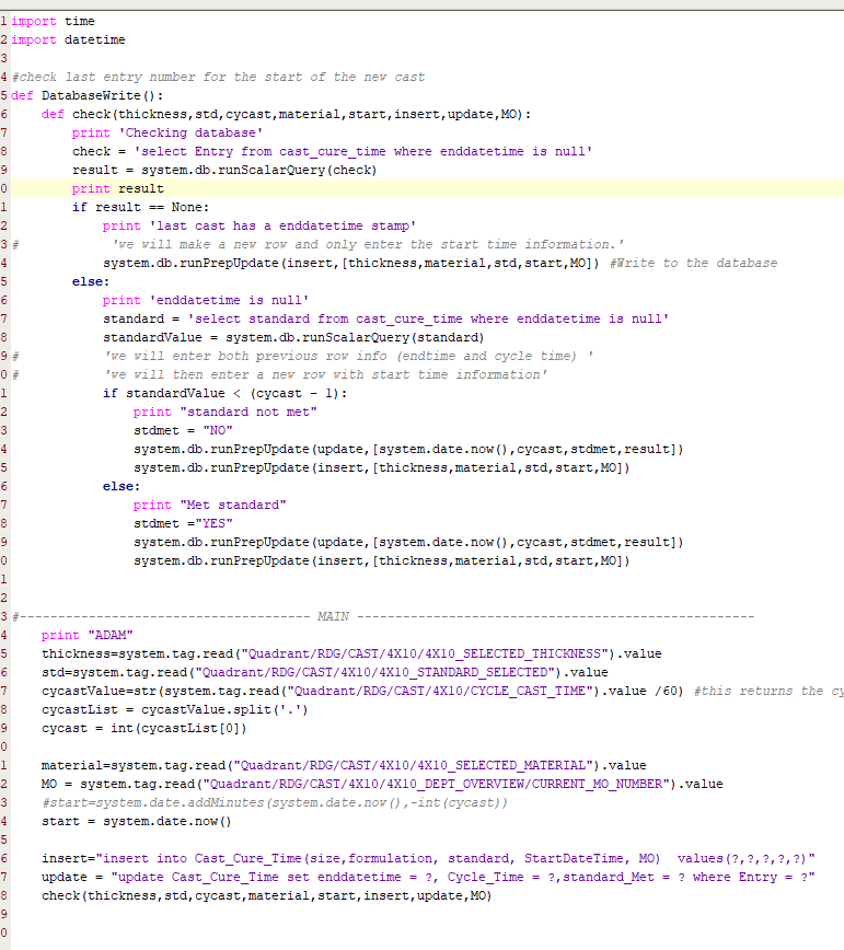

I have a gateway tag event that is looking at two opc tags and when they both go true I want my script to write to the database to run. Below are screenshot of both my tag event script and shared script
 ![](https://us1.discourse-cdn.com/inductiveautomation/original/2X/b/b2e6875c0b6f8bdacd75393318e045b3a0368dbb.png)
 ![](https://us1.discourse-cdn.com/inductiveautomation/original/2X/7/760facf60bb8a649353be511165aed5473182bae.png)
I went to my wrapper log on the gateway and realized that my print statements where writing twice which to me indicates that my event script is being called twice and I dont have the slightest idea on why.
unless its due to both tags being used as my change triggers
 ![](https://us1.discourse-cdn.com/inductiveautomation/original/2X/f/f4260aeb08181e9ae8321d572828a6fafea39240.png)

If both values change in the same OPC read cycle, it will indeed cause the script to be executed twice (both are true at that point).
A possible solution is to create an expression tag (the “and” of the two other tags), and react on that instead.

I was hoping that putting it in the if statement would neglect that from happening, but I’ll go ahead and do that. Thank you very much.
