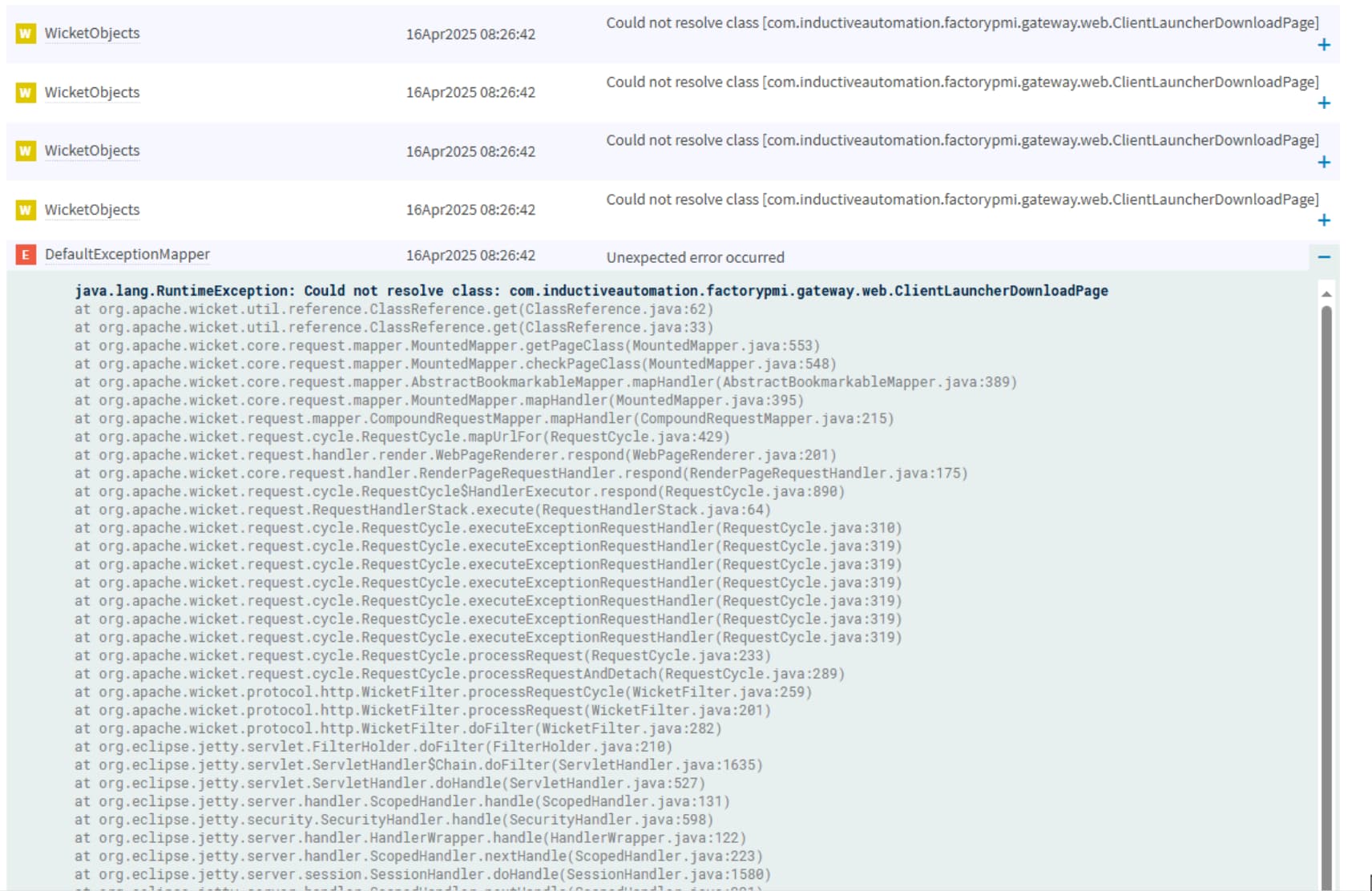

This is what I found in the gateway log file. That is the error which I do not know what is it, and how happend. I do not see that the
 ![CleanShot 2025-04-16 at 22.25.20@2x](https://us1.discourse-cdn.com/inductiveautomation/original/3X/a/2/a2cb56cc7271453d18fd9a68c2781f75d18c8155.jpeg)
**Post date:** [April 16, 2025, 8:44pm UTC](https://forum.inductiveautomation.com/t/gateway-web-page-blank-in-any-web-browser/105191/5 "2025-04-16T20:44:49Z")
That looks like a downstream "symptom" of some other weird issue. You said you installed around 100 gateways - how? An orchestration system like Kubernetes? Might be something wrong with that system - it looks like your gateway started up before all the files it needs were actually in place, or something like that.

I was expecting to see the restart of the gateway in the log files, before the issue happened and that some service didn't start properly, but no restart of the gateway in log file before issue. It looks like just happen

For future visitors: Support was able to track this down for me. This can occur if you uninstall the Vision module from the gateway webpage, then import project resources. If you reboot between those steps, you'll avoid the issue.
This is a one time issue with Wicket, and is resolved when you restart the gateway. I was also told this is no longer an issue in 8.3 🙂
