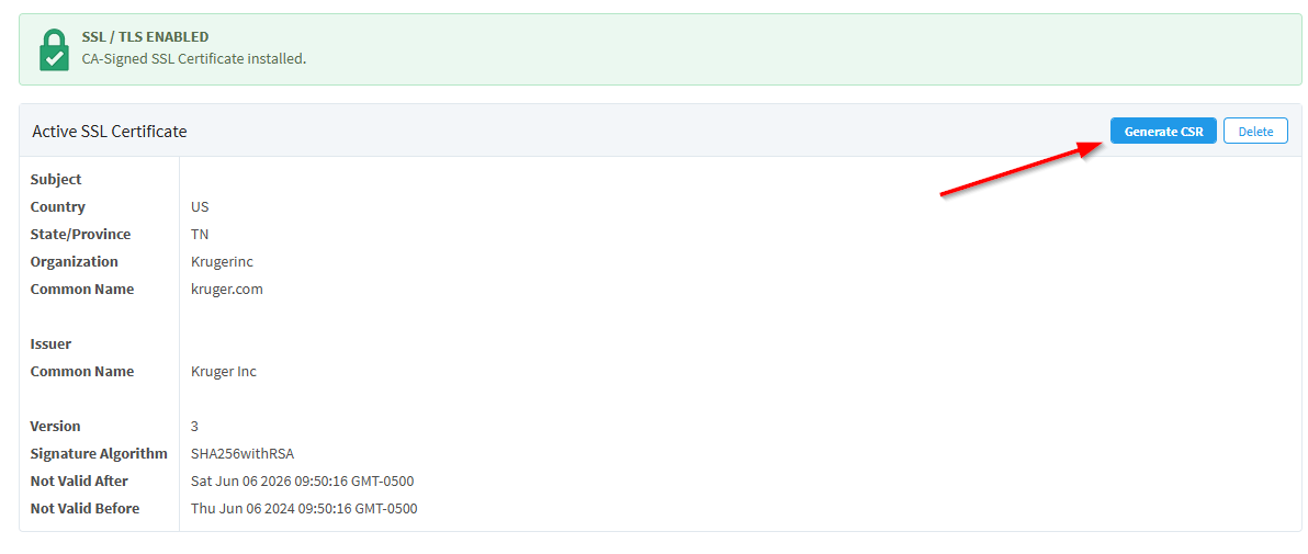

Hello,
Quick question: My gateway is already secured with a certificate and multiples clients are connected to it. But there is an error in the certificate and we need to regenerate it. Can I click “Generate CSR” without breaking the actual certificate?
 ![image](https://us1.discourse-cdn.com/inductiveautomation/original/3X/b/f/bf39fd34dcaa6c4f41f7ea0e19bef4a52cc4b55f.png)
**Author:** ![josborn](https://avatars.discourse-cdn.com/v4/letter/j/4bbf92/32.png) [@josborn](https://forum.inductiveautomation.com/u/josborn)\
**Post date:** [September 3, 2025, 8:34pm UTC](https://forum.inductiveautomation.com/t/generate-csr-button/110364/2 "2025-09-03T20:34:43Z")
Clicking that button will just let you download the .csr file, you wont be changing anything until you upload the certificate files.
