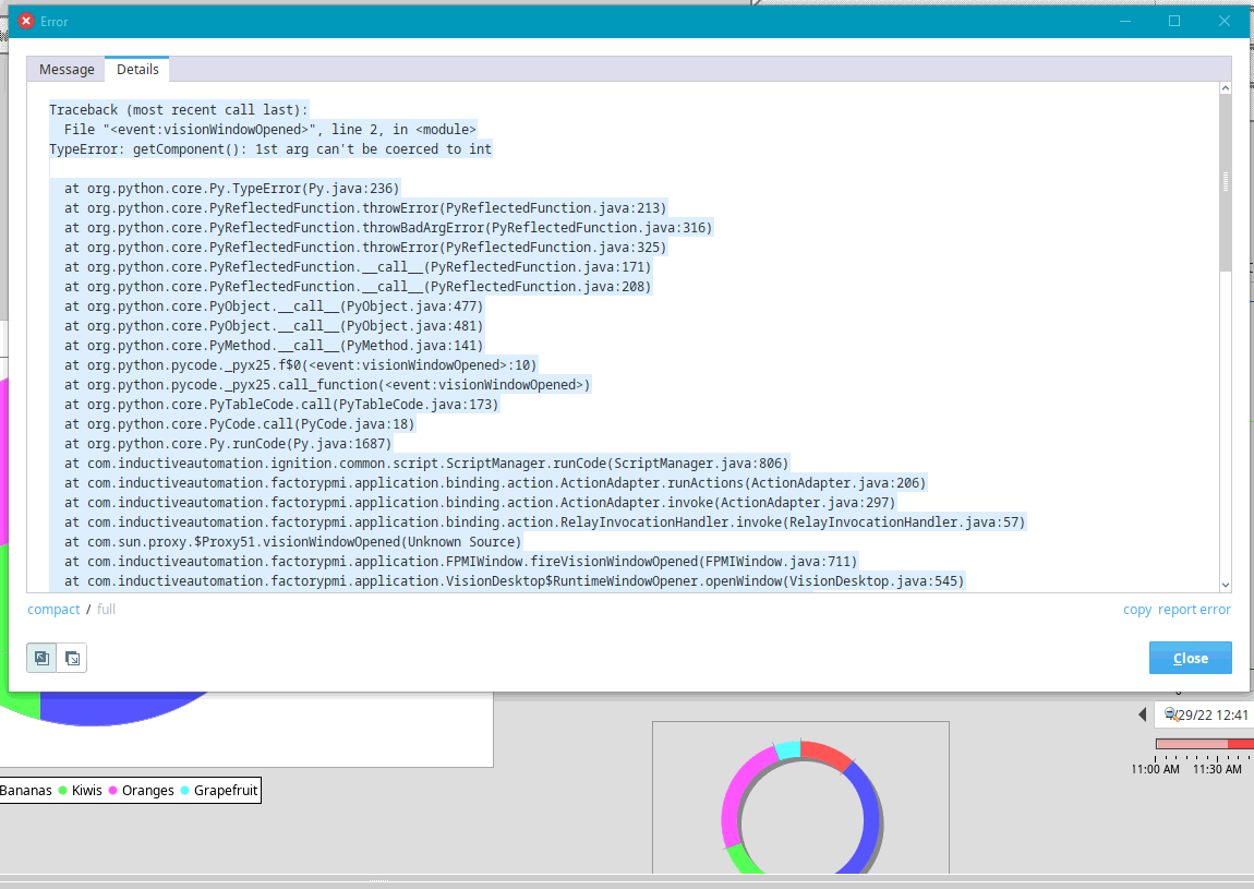

**Author:** ![andreia\_chiurato](https://avatars.discourse-cdn.com/v4/letter/a/a6a055/32.png) [@andreia\_chiurato](https://forum.inductiveautomation.com/u/andreia_chiurato)\
**Post date:** [April 29, 2022, 10:57am UTC](https://forum.inductiveautomation.com/t/get-rid-of-pie-chart-shadow/19544/8 "2022-04-29T10:57:48Z")
Hi, I did like this tip, but give an error, can you help me please?
 ![image](https://us1.discourse-cdn.com/inductiveautomation/original/3X/2/c/2c7e3435e6e8a17f1c8e985c8cf0319f983145d2.png)
 ![image](https://us1.discourse-cdn.com/inductiveautomation/original/3X/d/c/dcbba1f6ae584cfdb09ac2e42bc4757334c56273.png)

Traceback (most recent call last):
  File "<event:visionWindowOpened>", line 2, in <module>
TypeError: getComponent(): 1st arg can't be coerced to int

**Post date:** [April 29, 2022, 2:00pm UTC](https://forum.inductiveautomation.com/t/get-rid-of-pie-chart-shadow/19544/9 "2022-04-29T14:00:43Z")
You are using in a **window event** a script intended for an event on a button or other component that is a **sibling** of the chart. So, `event.source.parent` isn’t the right hierarchy. You probably want `event.source.rootContainer` in its place.
Tip: Use the property search wizard in the upper right to help you construct the python to reference other components.
