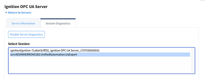

Not readily.
If you click "Server" under the Diagnostics column for a connection on the OPC Connections status page, you can then go to the Session Diagnostics tab, enable diagnostics on that Server, then count the Sessions:
 ![Screenshot 2025-09-10 at 11.52.39](https://us1.discourse-cdn.com/inductiveautomation/original/3X/e/7/e7787911975557746ede49fc77a85b176249512c.png)
Diagnostics are expensive and shouldn't be left enabled, though.

Is it possible that there is an OPC UA client connected that does not show up under the Sessions? I am using UAExpert as my opc client and Security Policy = None but I don’t see it appear under the Sessions. UAExpert is connected however and I am able to see tag values changing.

**Post date:** [September 10, 2025, 7:09pm UTC](https://forum.inductiveautomation.com/t/get-the-number-of-opc-ua-clients-connected-to-the-ignition-ua-server/110518/6 "2025-09-10T19:09:21Z")
Works on mine 🤷‍♂️

Restarted the OPC UA module. It looks like the connection is there - the blank row in the screenshot.
 ![image](https://us1.discourse-cdn.com/inductiveautomation/original/3X/b/2/b2a9042eb0536646ea4711e73b56f6973a18ddae.png)

The connection details also appear correctly, it’s just the row in the “Select Session” is blank. This connection uses Security Policy = None and Ignition does not have the UAExpert certificate so maybe that’s why it’s blank?
Either way, the main thing was to get the number of connections so this solution works. Thanks!

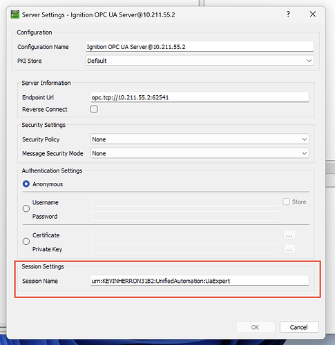

The Session name is supplied by the client when it creates the Session, not sure why yours is blank.
Check your UaExpert settings:
