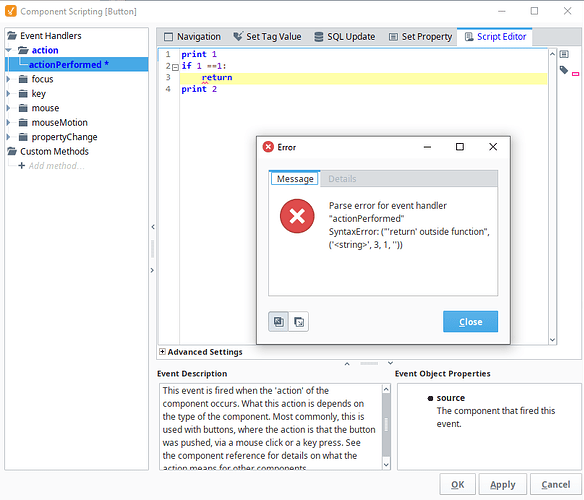

**Author:** ![Dawid\_Fulczynski](https://sea1.discourse-cdn.com/inductiveautomation/user_avatar/forum.inductiveautomation.com/dawid_fulczynski/32/12308_2.png) [@Dawid\_Fulczynski](https://forum.inductiveautomation.com/u/Dawid_Fulczynski)\
**Post date:** [February 25, 2023, 2:56pm UTC](https://forum.inductiveautomation.com/t/getting-error-using-sys-exit-or-exit/70176/9 "2023-02-25T14:56:13Z")
Cannot save script with return without function.

**Post date:** [February 25, 2023, 3:43pm UTC](https://forum.inductiveautomation.com/t/getting-error-using-sys-exit-or-exit/70176/11 "2023-02-25T15:43:37Z")
> [@lrose](#):
> Component scripts, really any scripts, are already functions.
Not true in Vision, for actual events. Nor older project events. Custom methods and extension methods are functions.
> [@Dawid\_Fulczynski](#):
> Are there any better way to exit from e.g. actionPerformed button component script ?
No. Moving the logic to a project script library is the right answer. Which you should do anyways, to avoid legacy scoping issues in project events. And make your code more maintainable.
