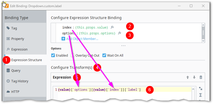

The OP's dropdown was structured like this:
```python
    "value": 0,
    "label": "Option 0"
    "value": 1,
    "label": "Option 1"
Selecting the second option from the dropdown would return `value : 1`.
The OP wanted to return the **label** for that option and thought that the way to that would be to treat the value as an pointer into the options list and then retrieve the label at that position. I provided a much simpler solution.
 ![Dropdown structure index](https://us1.discourse-cdn.com/inductiveautomation/original/3X/5/b/5b65460fd76b755f0e10b6b57cb4fc731d8b76d1.png)
To make it work the way the OP was trying:
Create an expression **structure** 1 and to collect the `index` pointer (the dropdown's `value`) and the dropdown options array.
Now the structure is passed to the Expression Transform as `{value}` which will look like
```python
   "index": 2, "options",
   "options" : [{"value": 0, "label": "Option 0"}, {"value": 1, "label": "Option 1"}, ...]
Now if `index = 1` the expression I supplied will evaluate as
`{value}['options'][1]['label']`
As explained, there's a much simpler way.
1 Note that it's an Expression **Structure** and not a simple Expression.

Thanks, I had mine structured the same way, with index and options just like you have shown. It didn't work though, it didn't like index (it liked selectedIndex but it didn't change with my selection).
Instead I Just added a transform and made the value an object with both value/label and it worked. I think that was the recommended way and seemed much easier.
Thanks!

@Transistor, your expression structure works perfectly when the value in the options is the same of the index, but in the case I'm woking on I have this options for example
```python
    "label": "Option 0",
    "value": 110
    "label": "Option 1",
    "value": 13
How could I manage it using the expression structure?
**Post date:** [May 5, 2025, 7:47am UTC](https://forum.inductiveautomation.com/t/getting-label-of-the-dropdown-component/84629/29 "2025-05-05T07:47:40Z")
You can add extra information into each option dictionary.
```python
    "value": 0,
    "returnValue": 110
    "value": 1,
    "returnValue": 13
Now the value will contain the array index (which you don't want) so create a custom property `returnValue` on the dropdown, add an expression binding
```python
try(
	{this.props.options}[{this.props.value}]['returnValue'],
	null
and use `custom.returnValue` where you might have previously used `value`.
The `try(..., null)` just prevents an error when nothing has been selected.
**Author:** ![pascal.fragnoud](https://sea1.discourse-cdn.com/inductiveautomation/user_avatar/forum.inductiveautomation.com/pascal.fragnoud/32/24728_2.png) [@pascal.fragnoud](https://forum.inductiveautomation.com/u/pascal.fragnoud)\
**Post date:** [May 5, 2025, 7:52am UTC](https://forum.inductiveautomation.com/t/getting-label-of-the-dropdown-component/84629/30 "2025-05-05T07:52:02Z")
I'd keep the `value` for the actual value and add an `index` property instead.
But what is all this for ? Why not just make `value` an object and add all that's needed here ?
