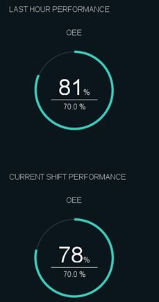

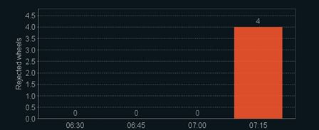

Hello Guys.
 ![Graph](https://us1.discourse-cdn.com/inductiveautomation/original/3X/9/f/9fd581396ec75e4918e6f81e737402343ed64fbb.jpeg) ![OEE](https://us1.discourse-cdn.com/inductiveautomation/original/3X/3/5/35d55477e97df9e37c9572d22e6c04102445787a.jpeg)
I need to plot Same graph & OEE.
which components i have to use in Ignition v7.9.8 designer,to Plot shown Graph & how to show OEE in Ignition Screen.
Can somebody guide me.

- [Bar graph](https://docs.inductiveautomation.com/display/DOC79/Bar+Chart)
I can see two ways for the second one.
- A [meter component](https://docs.inductiveautomation.com/display/DOC79/Meter) using the intervals as the indicator.
- A [pie chart](https://docs.inductiveautomation.com/display/DOC79/Pie+Chart) with a circle drawn over it to simulate the same thing.
**Author:** ![Rameshwar.kuthale](https://avatars.discourse-cdn.com/v4/letter/r/13edae/32.png) [@Rameshwar.kuthale](https://forum.inductiveautomation.com/u/Rameshwar.kuthale)\
**Post date:** [July 28, 2020, 10:54am UTC](https://forum.inductiveautomation.com/t/graph-oee-support/37149/3 "2020-07-28T10:54:04Z")
@JordanCClark, thank you so much.I will try with these options.
