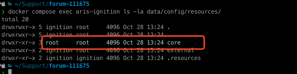

Upon inspection of this FAULTED gateway state, you'll also see that:
1. The base `core` config folder has the wrong permissions:

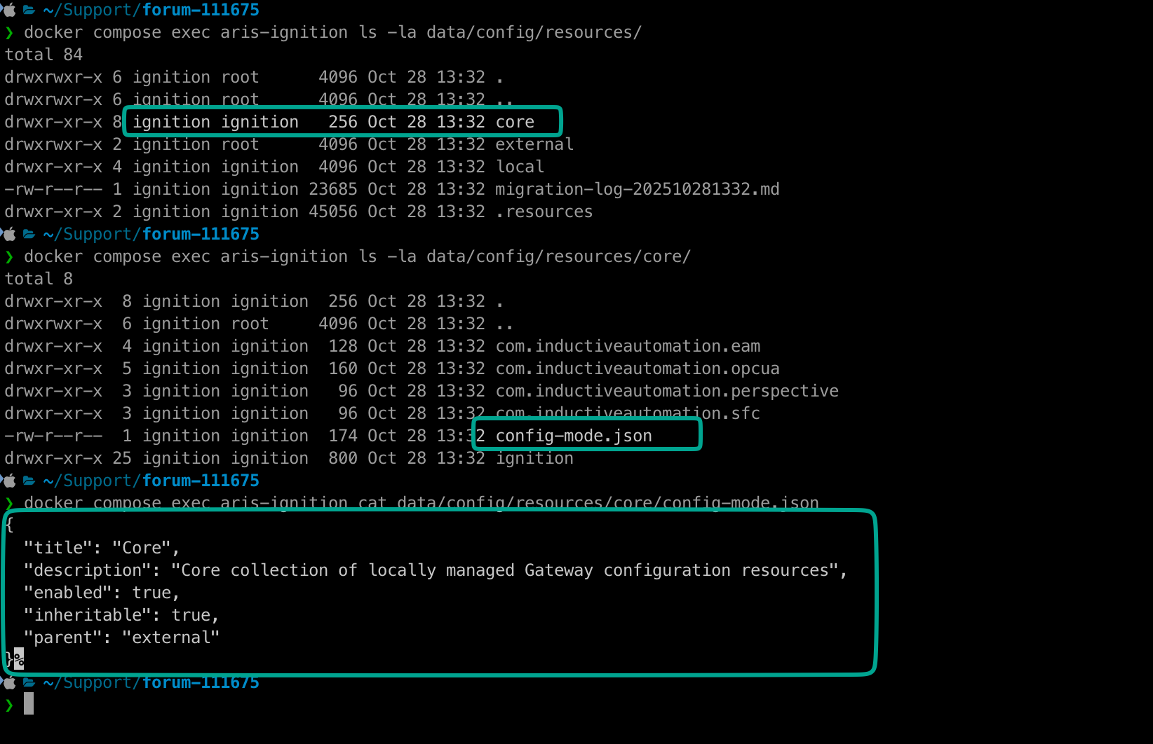

If you bind-mount to _just_ the `core` collection (as my suggested `docker-compose.yml` does), you can see a correct configuration upon inspection:
 ![SCR-20251028-iafj](https://us1.discourse-cdn.com/inductiveautomation/original/3X/8/4/84913f944bb2852314d9fc748c8671b62c657d88.png)
