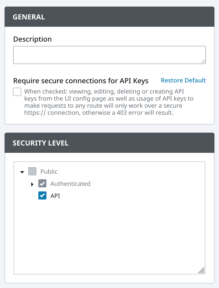

**Post date:** [July 29, 2025, 6:50pm UTC](https://forum.inductiveautomation.com/t/has-anyone-gotten-the-api-to-work/109101/4 "2025-07-29T18:50:56Z")
What security levels does your token have? It has to be given a permission that has read access to the gateway:
In `/app/platform/security/settings`:
 ![image](https://us1.discourse-cdn.com/inductiveautomation/original/3X/e/0/e00f08190b2f8a3e653e69e3c48dc4bda6800c88.png)
In `/app/platform/security/api-keys`:
 ![image](https://us1.discourse-cdn.com/inductiveautomation/original/3X/5/e/5e7cc42fff370f1c5509f28d36d6ad1f79cbe548.png)
`curl -H 'X-Ignition-API-Token: test:xxx' http://localhost:8088/data/api/v1/gateway-info`

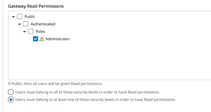

**Author:** ![mquinn](https://avatars.discourse-cdn.com/v4/letter/m/cab0a1/32.png) [@mquinn](https://forum.inductiveautomation.com/u/mquinn)\
**Post date:** [July 29, 2025, 7:06pm UTC](https://forum.inductiveautomation.com/t/has-anyone-gotten-the-api-to-work/109101/5 "2025-07-29T19:06:29Z")
I don't have an API checkbox in my gateway permissions configuration:
 ![image](https://us1.discourse-cdn.com/inductiveautomation/original/3X/1/8/186566ebbf1d89e80e42ed17f86d0de5b2f9b423.png)
This gateway was on 8.1 and upgraded. Maybe the upgrade didn't really get everything?
**Author:** ![Brad\_Fischer](https://sea1.discourse-cdn.com/inductiveautomation/user_avatar/forum.inductiveautomation.com/brad_fischer/32/84857_2.png) [@Brad\_Fischer](https://forum.inductiveautomation.com/u/Brad_Fischer)\
**Post date:** [July 29, 2025, 7:10pm UTC](https://forum.inductiveautomation.com/t/has-anyone-gotten-the-api-to-work/109101/6 "2025-07-29T19:10:53Z")
You'll need to create a new Security Level. Go to [http://gatewayIP](http://gatewayIP):Port/app/platform/security/levels, highlight "Public" and select "Add Level". Make sure you update your API Key to use this new level.
**Post date:** [July 29, 2025, 7:20pm UTC](https://forum.inductiveautomation.com/t/has-anyone-gotten-the-api-to-work/109101/7 "2025-07-29T19:20:22Z")
That's got it, thank you.
