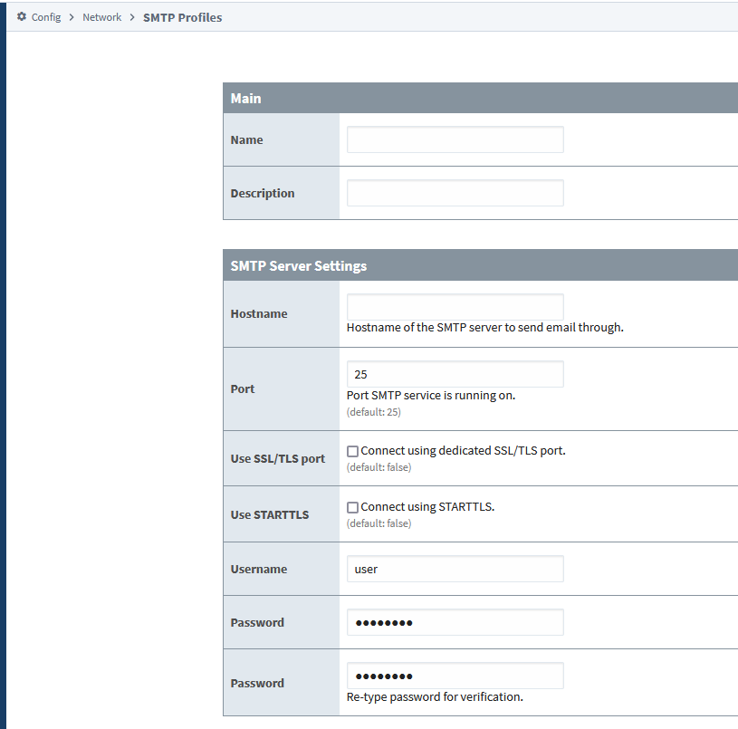

I want to save the password for configuration setting (e.g. new SMTP profile). If I write insert plain text for password column in `SMTPSETTINGS` table of internal database I get no error but going back to Email Settings option on gateway webpage shows Internal Error.
 ![image](https://us1.discourse-cdn.com/inductiveautomation/original/3X/1/2/12dc6dbe9303f771f443c4d394541470dababe96.png)
Skipping password column in insert query does create a new SMTP profile. So I think I need to encrypt the plain text before inserting the value.
 ![image](https://us1.discourse-cdn.com/inductiveautomation/original/3X/a/d/adb56f4eb16b1f66b336efb6c8deb5fee09e29e3.png)
I tried SHA1 algorithm to encrypt the password (‘password’) and inserted in internal DB table. It gets inserted as below but I get _Internal Error_

In above table both SMTP5 and SMTP6 have same password ‘password’, so SHA1 is not the correct encryption. MD5 encryption returns ‘X03MO1qnZdYdgyfeuILPmQ==’ for ‘password’ and give the same _Internal Error_ on adding to database.
Is there any way to find which encryption algorithm is used?
**Post date:** [December 11, 2021, 6:20pm UTC](https://forum.inductiveautomation.com/t/hash-algorithm-for-storing-password-in-internal-db/54015/2 "2021-12-11T18:20:13Z")
These passwords aren’t hashed, they are obfuscated via symmetric encryption using a “hidden” key and then encoded in hex.
You can import `com.inductiveautomation.ignition.common.GatewaySec` and use the encrypt/decrypt methods instead of trying to do it yourself.
