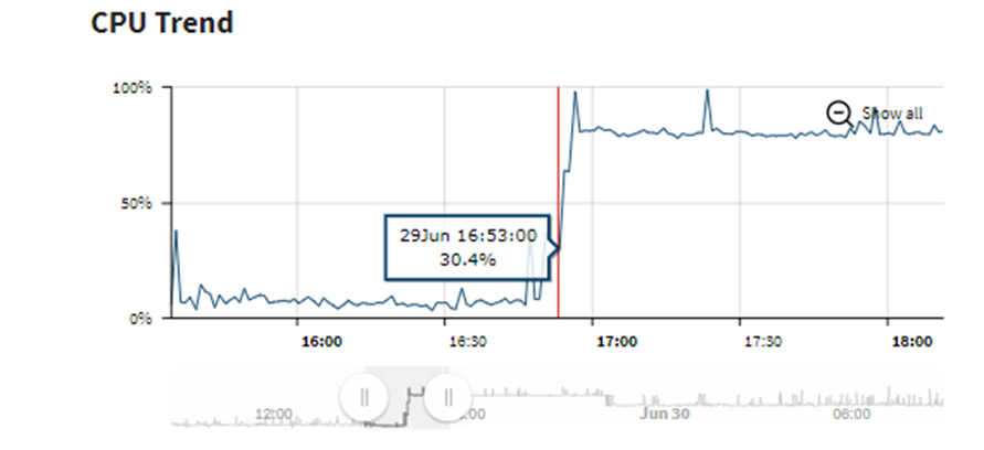

**Short version**
Is there an issue with the audit log causing some kind of cpu usage loop?
Is PropertiesFactory loading a properties files from jar files on the gateway something my company added or something native to Ignition?
What is that?
My CPU utilization cranked up to 80% for hours and hasn't gone below 50% since.
I will probably restart soon, but I want to do some investigating first.
I am using Ignition 8.1.19
I was trying to look at audit logs on the gateway.
I did a search for a target using `%machineName%` for example over the last 6 months.
The gateway started to hang.
 ![image](https://us1.discourse-cdn.com/inductiveautomation/original/3X/1/8/18127fe9f88203bb81f562dfd13b93360984fbe9.png)
I thought hanging would be the end of it.
However, instead the CPU utilization went to 80%, stayed there for hours, and still has not gone back down since.
The timestamps seem to line up with the first audit search hanging.
29Jun2023 16:53:22 is when I had the first issue with the audit.

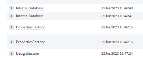

From the diagnostics log, I had these repeating issues from that one audit that hung.
 ![image](https://us1.discourse-cdn.com/inductiveautomation/original/3X/7/7/77fc6c869a3725a0bda4ab19e9a7d1a94b10c305.png)
 ![image](https://us1.discourse-cdn.com/inductiveautomation/original/3X/c/9/c906df89ab70a75cdd0f47d4ae00383b9baae7aa.png)
The other event that happened just before were an internal database
 ![image](https://us1.discourse-cdn.com/inductiveautomation/original/3X/2/e/2e1d3e46cb1c40e327d54b4a4346cf31dc8a12bf.png)
The propertiesfactory items happened at the same time, a double loading of the same properties files.
Then the InternalDatabase items were a double creation of auto-backup of internal database config.idb.
It is kind of hard to tell which of these events are the causal one for the CPU going high, and then I don't know why it has remained high ever since, ranging from 50-90,instead of hovering around 10%.
I suspect that the double call of loading properties files from jar files in the gateway from a wicket extension something apache might be the issue.
Looking at the timestamps and the curve, it seems like it might be the audit search caused a looping issue that has not gone away, but I think that is definitely native to Ignition.
I thought the other thing happened 2 times simultaneously which seems like a bug somewhere.

Upon restart, I am back to 5-10% cpu.
The automated PropertiesFactory event triggered before I could manually test the audit use impact.
CPU went up a little then returned to base levels 5-10%.
On the 5th I will test the audit. (So the authorized person who restarts the gateway service is available.)
**Has using the audit logs in the gateway been an issue for anyone else?**
Right now it seems like that might the issue.
**Is the PropertyFactory event supposed to double trigger?**
